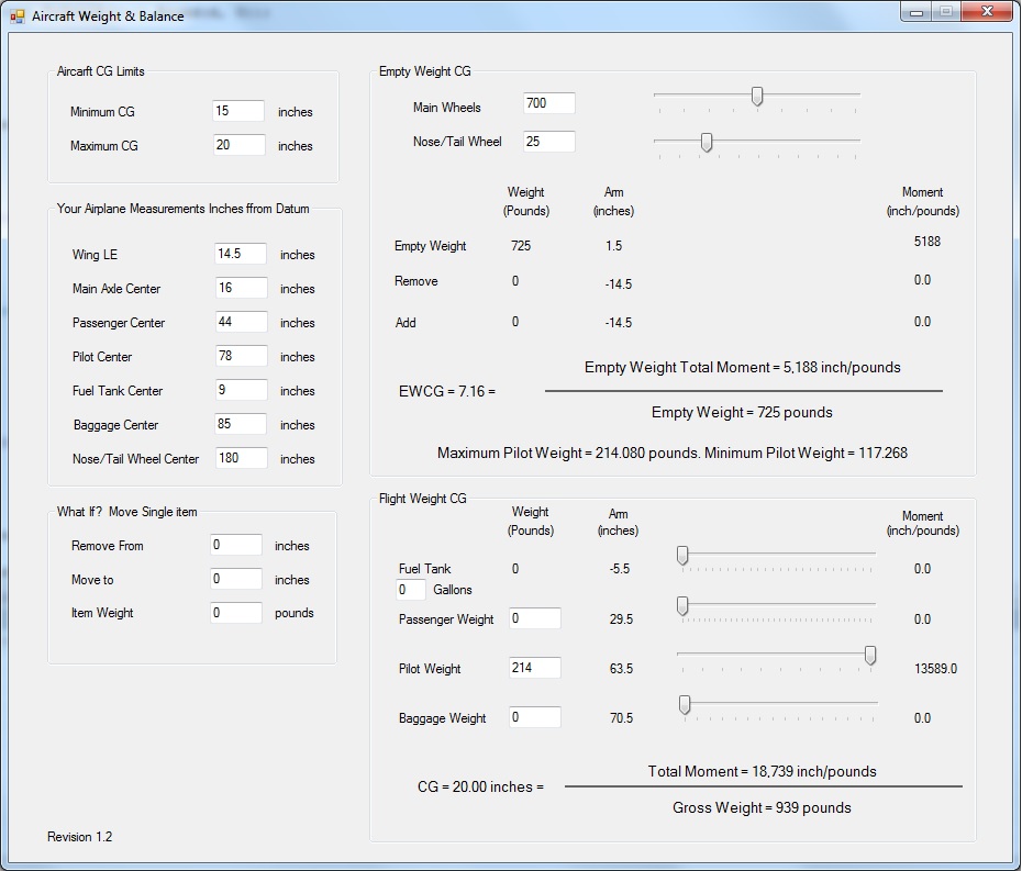

| Subject:  | Re: W & B, CG, and LG location question |
      For those of you following the W&B discussion I am reminding the Piet builders
      that I wrote a little W&B app that makes it very easy and very intuitive to play
      W&B "what-if" scenarios including moving an item -such as an engine or a battery
      to see how it changes CG.
      If you want a copy email me OFF list at rdewenter at woh.rr.com
      I still owe this to Jack T and one other gentleman this app - sorry Im late on
      this guys its on its way.
      There is even a calculation for Max pilot weight - (used for worst case scenario
      - no fuel situation).  The min pilot weight is a little flaky it does not work
      in all situations but max pilot does its intended job perfectly.
      After using it myself I could see how a properly built airplane is harder to get
      loaded out of CG - perhaps the Pietenpol is not as impervious to this as a C-172
      but its a great learning tool.  It also demonstrates how a light plane is
      MORE easy to get out of CG than a HEAVY one.
      Food for thought
      Bob 'Early Builder' Dewenter
      Dayton OH
