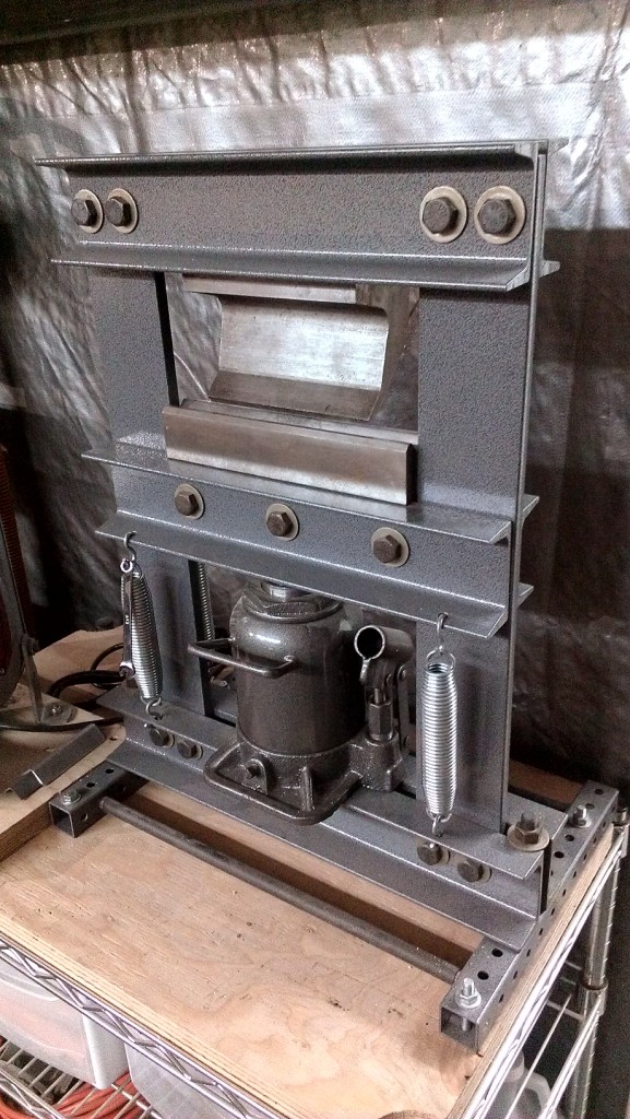

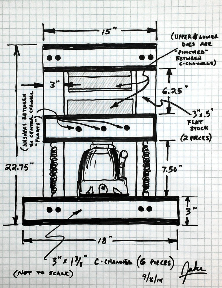

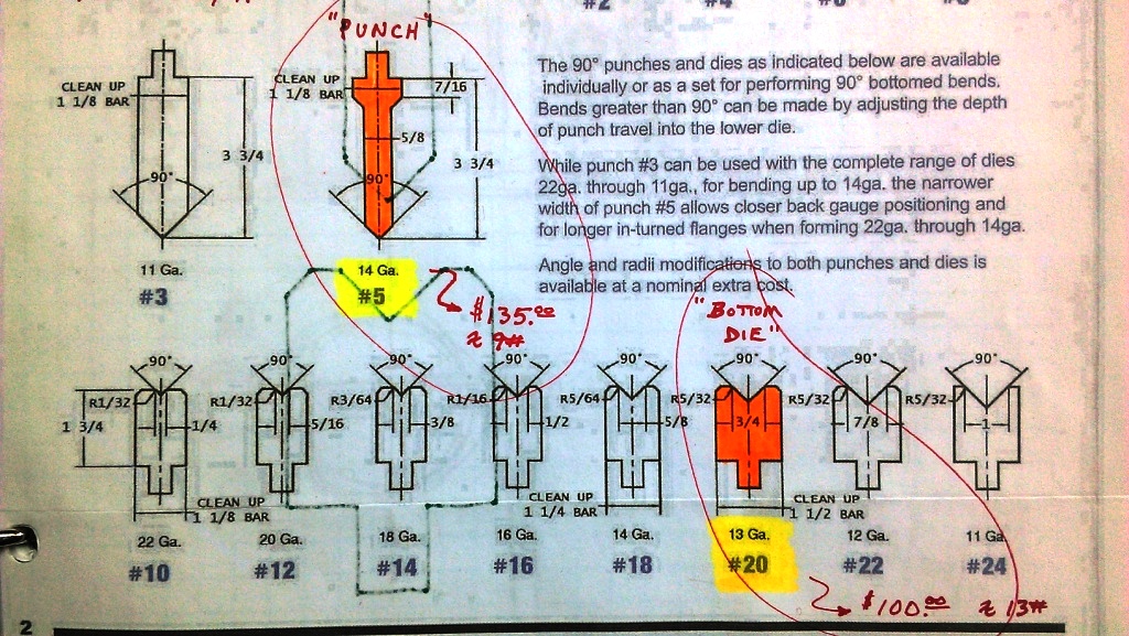

| Subject:  | Press Brake dimensions..... |
      Hello good Piet-Ple,
      A couple of people on this list have asked about the press brake that I built to
      form the 4130 fittings for my Pietenpol.
      Yesterday I drew up these dimensions and shot a few photos for Curt in Texas, so
      I thought I'd post them for anyone who may want to build it. It only requires
      a few steel parts and a low-profile 20-ton bottle jack from Harbor Freight -
      hey, it works.  The only part(s) that are tough to get are the dies and I bought
      mine from "Midwest Press Brake Dies, inc."  I would buy a "gooseneck" upper
      die if I did it all over again as I found one at a used machinery shop in Seattle
      and it'll bend some of the "u" shaped parts much easier.
      Anyway, hope this helps some of you out there...........
      Enjoy.....

Message 9
| Subject:  | Re: Press Brake dimensions..... |
      Ta Da!
      Curt Merdan
      Flower Mound, TX
      http://forums.matronics.com/viewtopic.php?p=430268#430268
      http://forums.matronics.com//files/image_905.jpg
Message 10
      Nice.....!  Glad it should help make the parts more enjoyable to build..........
