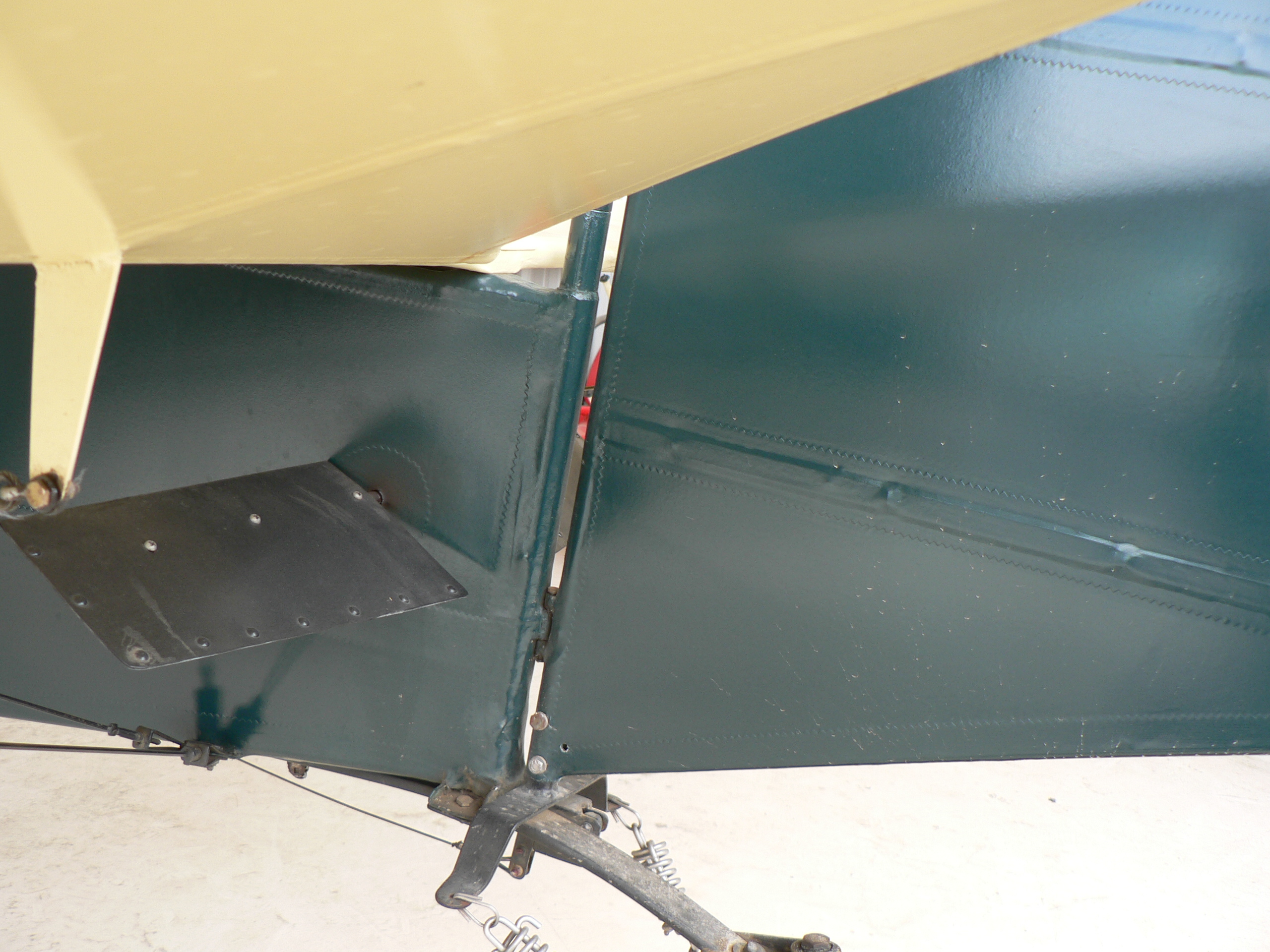

Gardiner,
Here are some pics of mine. I can only seem to add one pic at a time so there
will be 3 post. Lets give it a try.

Message 3
| Subject: | Re: advice on trim mechanism |
Simple bell crank with tension spring on one side and a pull cable on the other.

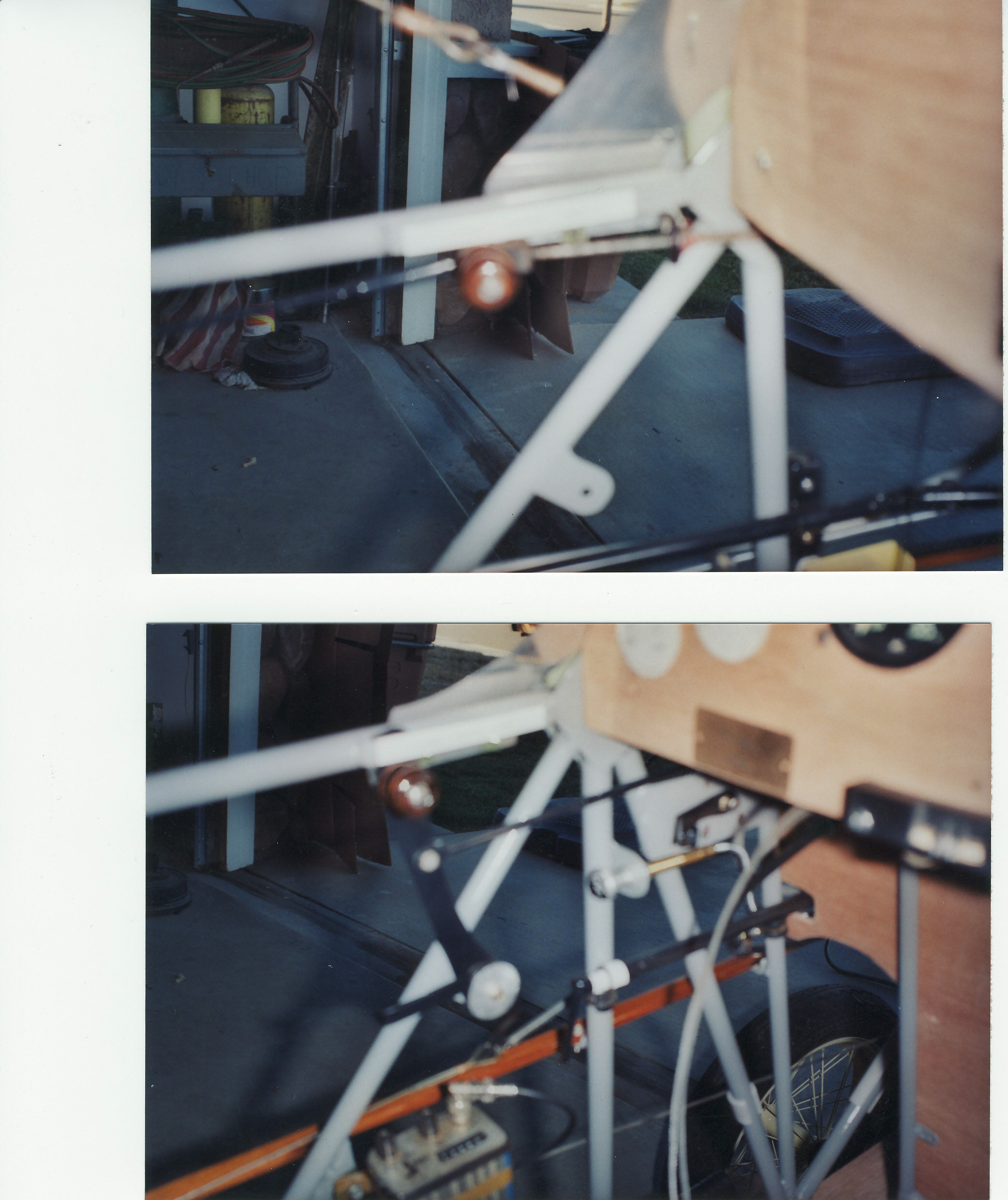

Message 4
Again with a simple bell crank with a tension spring, pull cable attached to it
and a friction ajustment to hold it in position. It is a VERY effective trim
tab. Sorry for the fuzzy pic but it is all I have right now. The bell crank
is at the base of the throttle lever.

Message 5
At a certain fuel level, mine will fly hands off in pitch,
but I have a bit more washout on the left wing than t
he right and without feet on the rudder bar, mine will gra
dually turn left. Gonna try and fix that with a new front
right strut fitting over the winter, and possibly an elevator
trim gizmo. =0A=0A=0AMatt Paxton=0ANX629ML=0A=0A=0A=0A-----Original Mess
