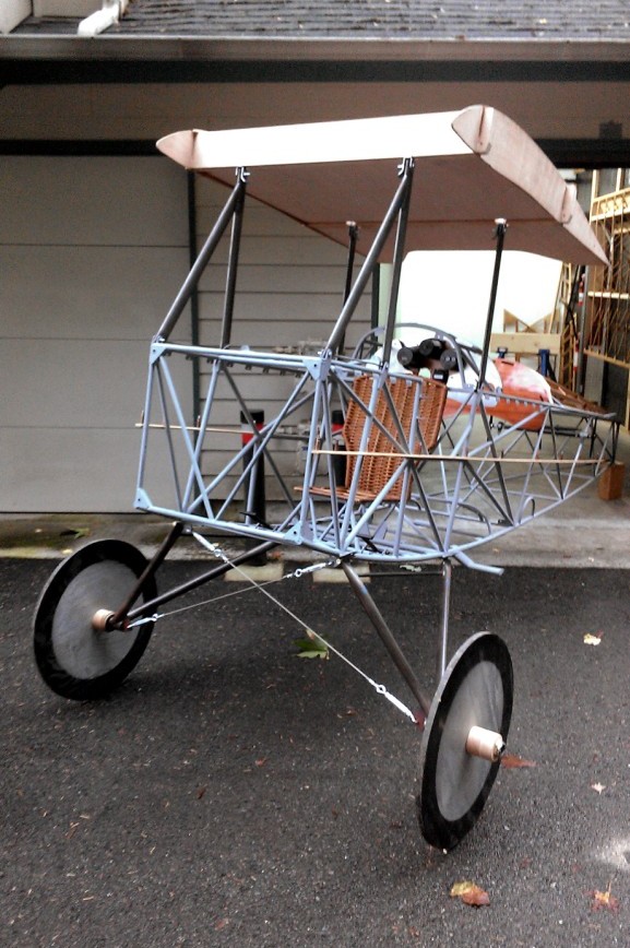

Hello good Piet-ple,
A quick update to share some progress on my project. My welder (Mike from Ready
Weld) stopped by a couple times last week to apply some talent to the cabaine
struts and center-section fittings. I have run the W&B numbers and decided to
weld the cabaine struts in the 90 degree vertical position. I will fine tune
the weight and balance in ways other than adjusting the struts. In this way, the
cabaine struts are SOLID structure for the "I hope it never happens" putting
it on her back situation..... but if it does happen I want a rigid structure
to protect me and my pax.
Hope all if you are enjoying fall - or what WE Pietenpol folks describe as "plane
building season." (The summer has way too many distractions!)
Jake
P.S. I built my center-section 42" wide so I can carry more gas in the overhead.
This should eliminate the need for a second, header tank.

She's a beauty, Jake! Looking very nice. Good logic with the extended centersection
in order to eliminate a header tank. Gravity never stops working and simpler
is better.
With the reduced rolling resistance you'll get with those ultra-skinny tires, I'll
bet you already have enough lift from just the centersection to get you up
to takeoff speed and in ground effect!
