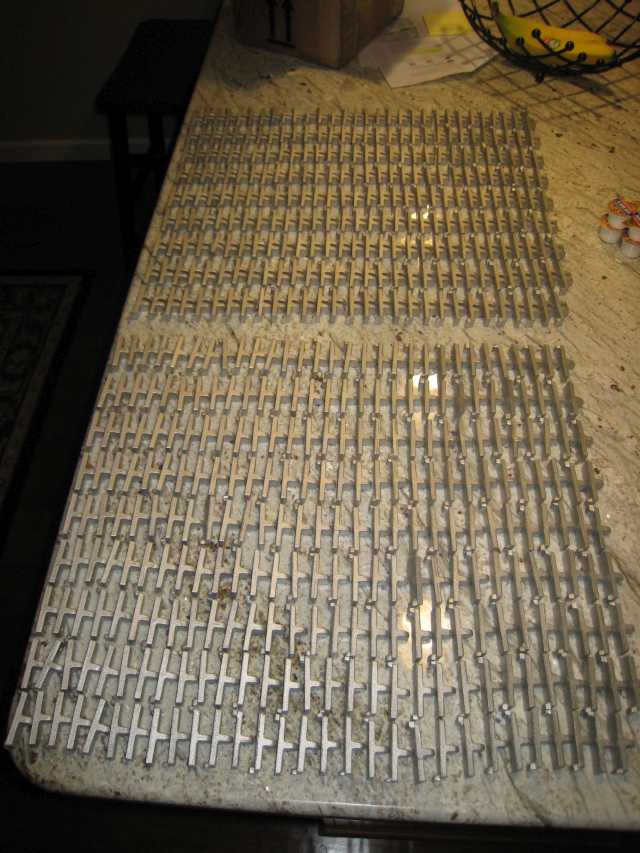

      Oscar, Put me on the list to buy. I don't need them now but would like a
      set on the shelf.

      On Wed, Nov 5, 2014 at 11:15 PM, taildrags <taildrags@hotmail.com> wrote:
      > Howdy, low 'n' slow fliers;
      > To all who were interested in the Kapler style cast aluminum tail hinges,
      > thank you for your patience.  I recently received a batch of castings from
      > the foundry and they are quite good.  With the small stock of castings that
      > I got from Vi when I bought his parts and tooling, I now have enough
      > material to produce about 30 sets of hinges (9 pairs).  In the attached
      > photo you can see what 269 pairs of the rough castings look like, but there
      > are a few rejects among them and I have yet to begin machining them to
      > final shape (all by hand), which may turn up a void or flaw in a couple
      > more.  The foundry and my supplier were very good to me, so I can continue
      > to offer them at what I think is a reasonable price: $72 a set plus $3
      > shipping in the U.S., total of $75 for the nine pairs of hinges that go in
      > the tail group on an Air Camper.  I've found out that these hinges are
      > nearly identical to those used on the W.A.R. replicas, so there may be a
      > wider market for them than I originally!
      >   thought, but I'm not sure of that yet.  My first priority will be to
      > supply Piet builders.
