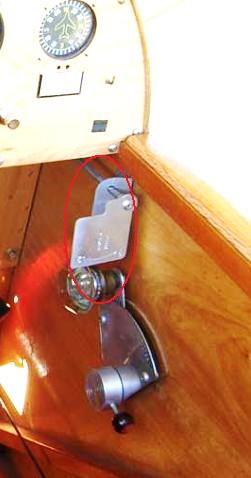

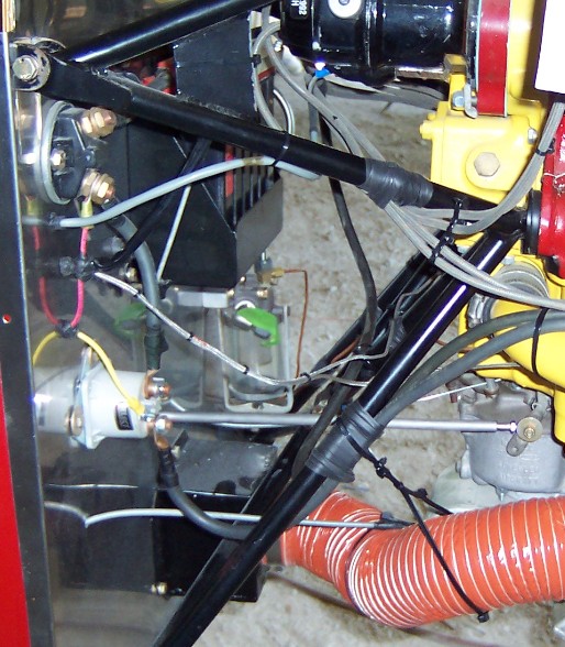

I used a mechanical switch with zero drain.
http://www.harborfreight(.)com/heavy-duty-battery-cutoff-switch-66789.html
I ran a 1/4" OD stainless tube from the rear pit to the firewall to turn it. The
operating handle is behind the firewall. see picture. Works fine but in my case
I have electric oil# and temp gauges and if left on long enough it will discharge
the battery. Rotate the circled piece up 90 degrees turns it on. The solenoid
is for the starter. The switch is rotary....turns either direction or

Message 10
| Subject: | Re: Question about solenoid and a new video |
Thanks for the replies. Lots of interesting information!
To distill my question to its essence: Is it useful to have a starter solenoid
in a pull-starter system? I think that the pull starter set-up acts as a mechanical
starter solenoid. I'm not coming up with scenarios in which the redundancy
of an electrical solenoid in line with the mechanical system is worthwhile.
I'm only considering this because I already have a solenoid installed on the
firewall.
http://forums.matronics.com/viewtopic.php?p=433922#433922

Message 12
Hi Jeff,
Nice video. I don't have the patience for that kind of thing.
Anyway, if all you are using the Battery for is starting then you don't need the
second solenoid. That is what the cable type starter is doing for you. If
you are running power to your radio through the firewall mounted solenoid then
it might be advantageous to keep it. At least you can shut the power off when
the plane is parked.
Good question. Cu-do's for recognizing it as extra weight or even more stuff to
go wrong.
Happy Landings,
Scott Liefeld
Flying N11MS since March 1972
Steel Tube
C-85-12
Wire Wheels
Brodhead in 1996
http://forums.matronics.com/viewtopic.php?p=433934#433934
Message 13
| Subject: | Re: Starter solenoid |
Jeff,
Consider this...
If your electrical bus is powered on during startup, the electrical spike from
the starter pull switch could possibly trash radio's, transponder, etc. Also,
if jump starting, or connecting a charger to battery, etc., you could accidentally
cause a spike on your electrical system.
As we all know, Murphy's law tells us that at exactly the time a switch is left
on accidentally, the spike will happen...
One of the purposes of a Master Switch and/or Avionics Master is to isolate your
pricey electronics from spikes. etc.
I agree with you; it would appear better to either replace with a toggle switch
of some sort - to eliminate the Solenoid pull in / hold in current, or have some
other form of low power dissipation device to eliminate the current draw.
Tom Kreiner
http://forums.matronics.com/viewtopic.php?p=433937#433937
