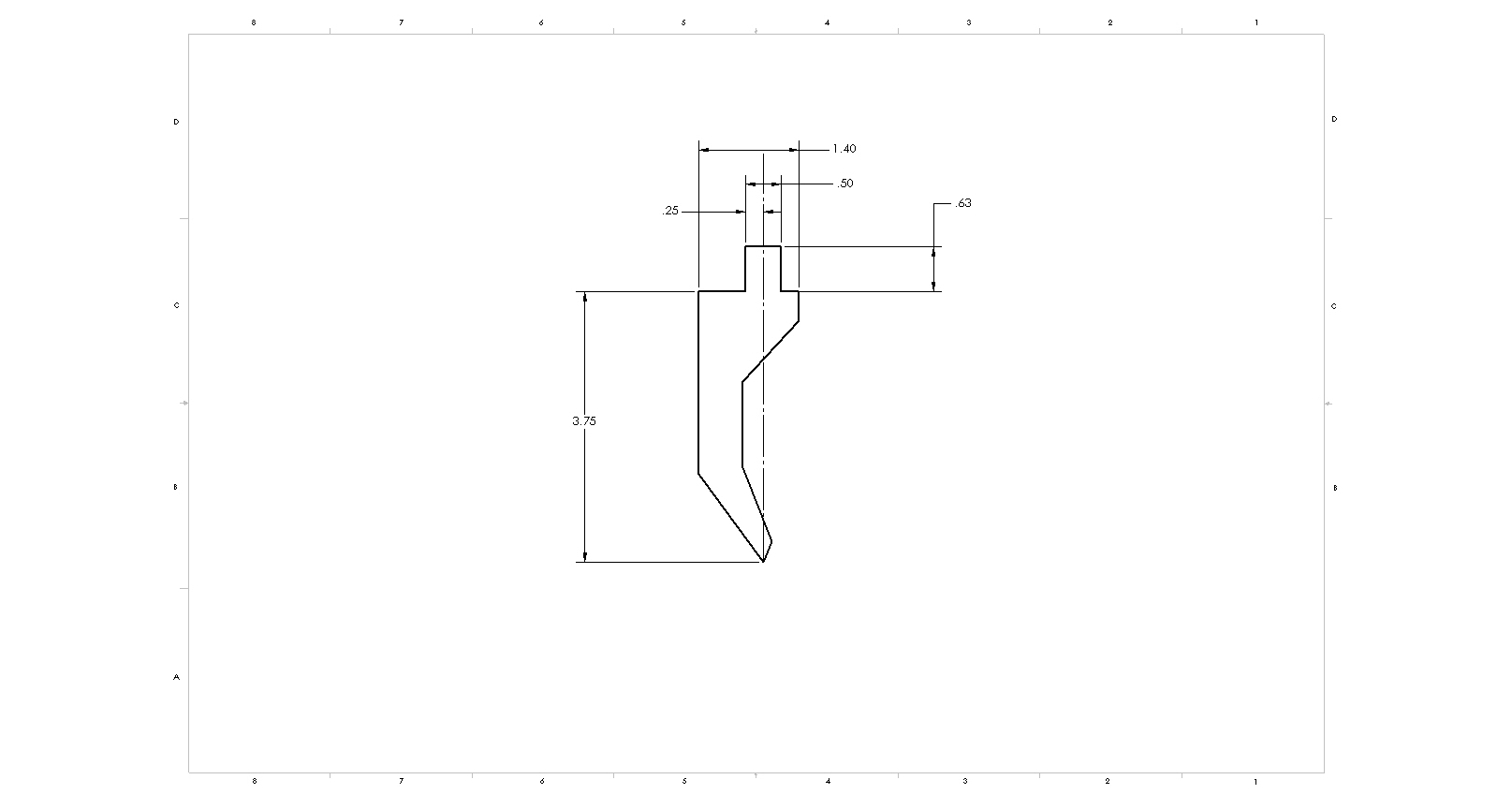

Tom I searched the archives for a picture and couldn't find one. Can you share
one? Are they stainless? Thanks!

Jack,
The pic of the Die is attached although not all the dim's are shown. If you need
additional info, I can measure the die, and add additional dim's.
The material is alloy steel, probable 1018, or thereabouts. There is no nose radius,
so I'm going to add one for my own bending, maybe .09 or so.
Bending our U shapes fittings should be pretty easy with this. You will need to
procure or mill a VEE block, as I don't have any of those.
Tom Kreiner
http://forums.matronics.com/viewtopic.php?p=435544#435544

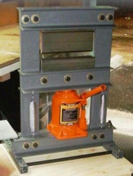

I'll take a 9" length if that is possible....?
My press brake has a 9 &1/8" opening - so less than 9" is ok but it can't be greater.
THANK YOU...!

Message 7
| Subject: | Re: Gooseneck Die |
See pic of my home-made press...
Jake Schultz - curator,
Newport Way Air Museum (OK, it's just my home)
http://forums.matronics.com/viewtopic.php?p=435548#435548
http://forums.matronics.com//files/2014_12_09_18_46_04_1_427.jpg
