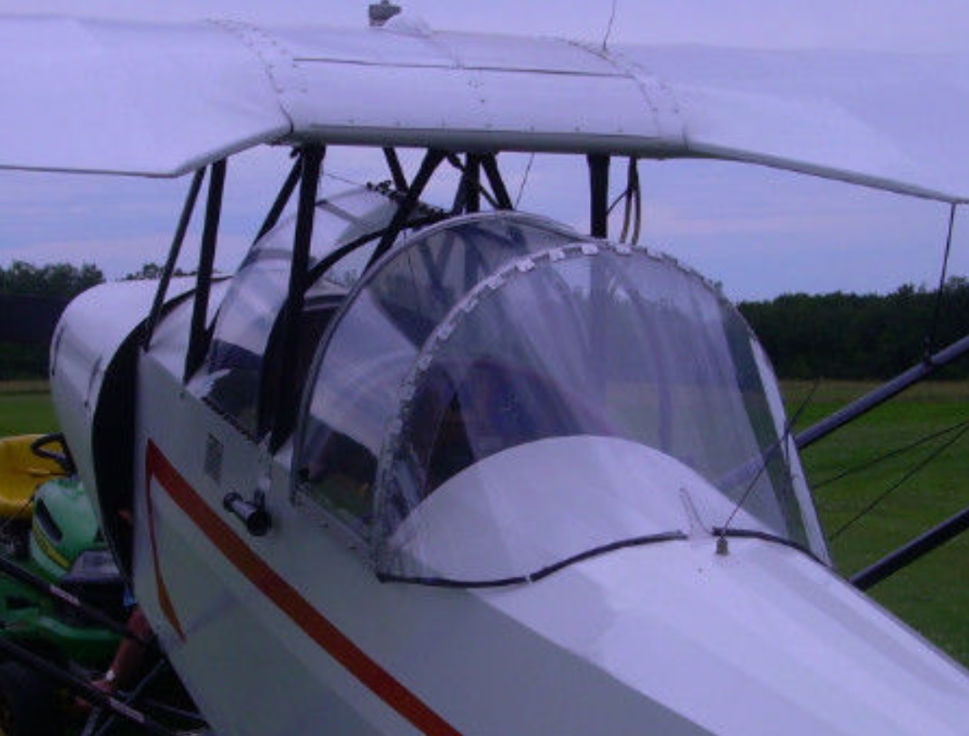

      Looking at the other photos from the Kijiji ad, it looks like the front canopy
      has a hinge on the top, right down the center.  And the rear canopy has a slot
      cut into the back edge, like it would need to clear the antenna, if it was designed
      to slide back.  However, there doesn't appear to be a track to slide on,
      so not sure how that might work.

      Interesting thoughts everyone.  The front pit is just hard to get into without
      the canopy.  Perhaps the owner or someone near him has the answer.  I'm sure it
      is easy once explained.

      So many ways to skin a cat...
      The back one doesn't need a track to come back, and the antenna would keep it from
      coming all the way out...
      Getting in the front like that though, wow.  Could be a bifold mechanism.
      Any of the MN crowd working on a solution?!
