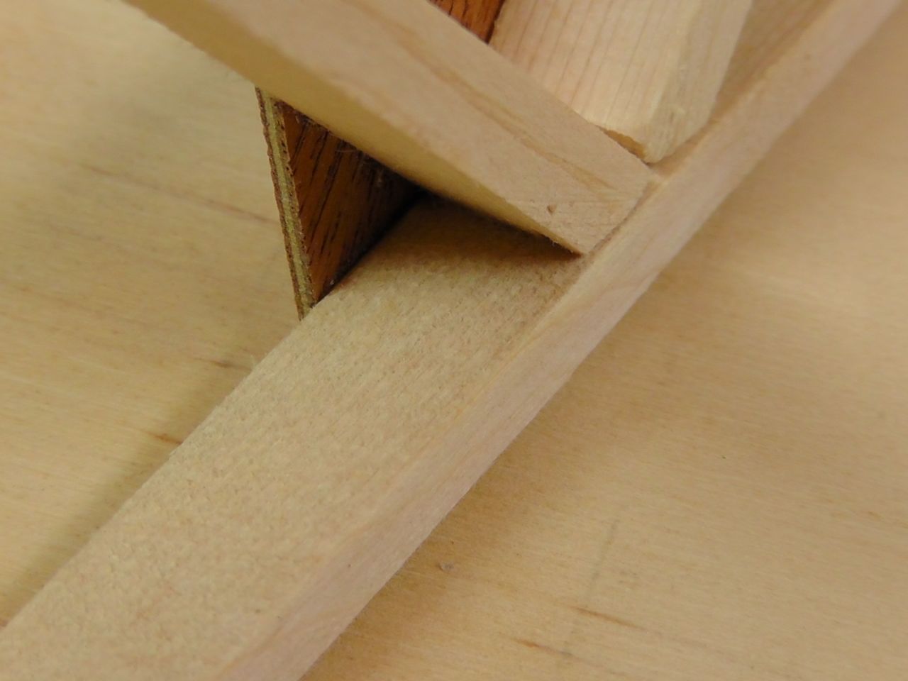

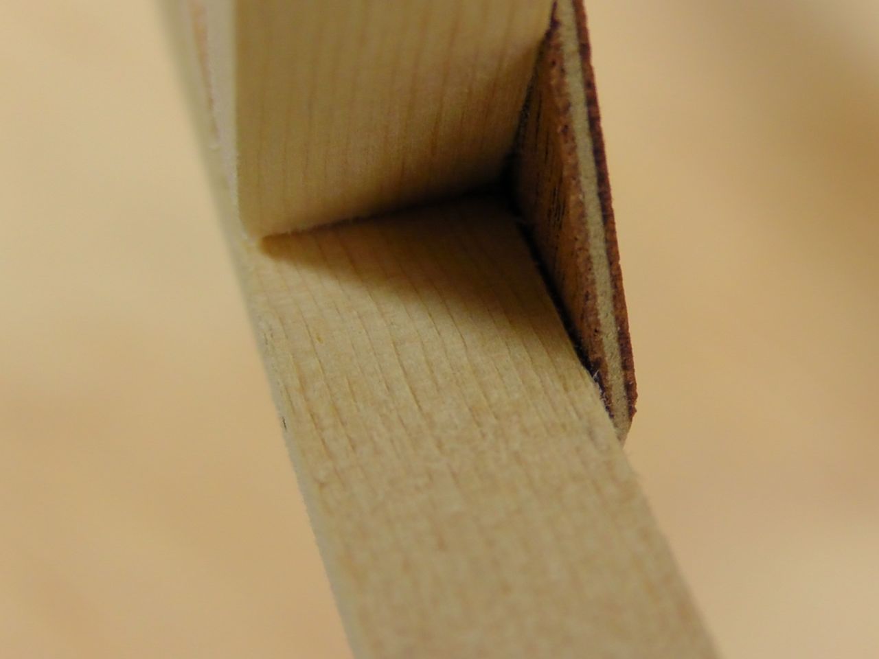

      Just discovered this wave in the grain of a rib top capstrip where two diagonals
      meet at gussets. The other side doesn't show the wave as far as I can see. Not
      sure if it's acceptable or not, but I was thinking of gluing additional pieces
      of capstrip on both sides of the diagonals like Tony shows in "The Sportplane
      Builder" page 67.
      Is it strange it's not on both sides? I plan to show my EAA counselor too, just
      wanted to share. Thanks.
      John

      It's wood... Lots of natural variation.
      Cap strips aren't structural, it'll be fine.
      Tools

      Thanks! The piece annoys me though, so maybe I'll just replace it.
      John
      http://forums.matronics.com/viewtopic.php?p=438338#438338

      It also occurs within the confines of gusset plates, a butt joint would be fine
      there.
      Tools
