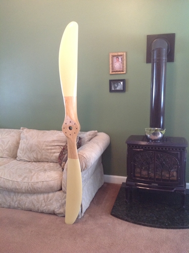

Its all about the math. Prop design is about Engine HP, torque, RPM, speed, etc.
The reason multiple blades are use is not for noise but for turning the HP into
thrust. Noise reduction has to do with blade design profiles.
Anyway have fun .... your 4-blade prop will need to be thin and small in diameter
to get the thrust you need, but you will find that out as you experiment.
Based on my Model-A engines HP and other known facts, my propeller calculations
for the 2nd prop I carved was this one. Its the one we flew with.
Here is some in site: Simplified propeller design for low-powered airplanes
https://archive.org/stream/nasa_techdoc_19930080999/19930080999#page/n3/mode/2up
Cheers ... I will be quite now.
WF2
http://forums.matronics.com/viewtopic.php?p=438759#438759
http://forums.matronics.com//files/m_01fb956990cac72515cb0ce22f9790dd3a4fd39ba5_193.jpg
http://forums.matronics.com//files/m_01afcc644ff0cd3005372b950f259aabde769c000e_172.jpg
