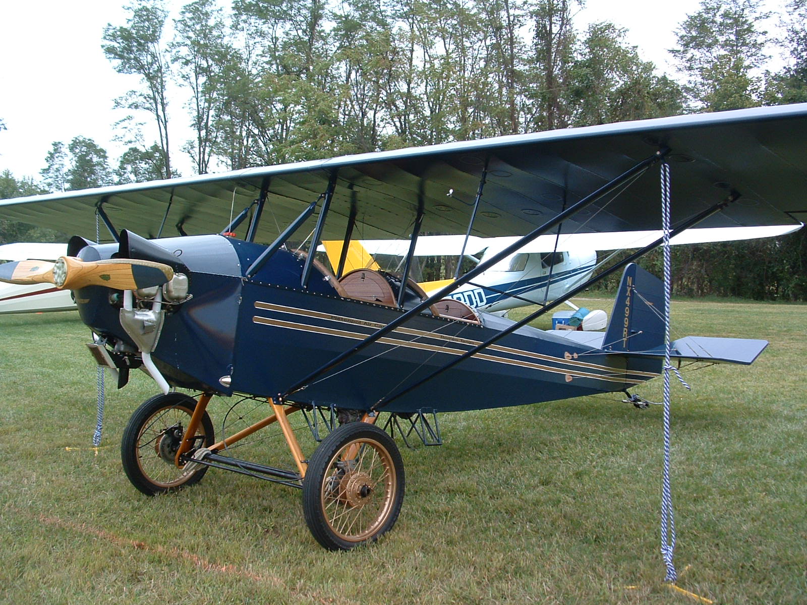

Message 6
| Subject: | Re: What color is this Pietenpol? |
as I said on FB...
http://forums.matronics.com/viewtopic.php?p=439033#439033
http://forums.matronics.com//files/497000120_t2qkm_o_352.jpg

| Subject: | what color is this plane, control horns, etc |
I think this is Rob Bach's plane which is blue and gold. He flew it to
Brodhead a few times, and it's really a nice plane. Cool instrument panels,
lots of brass if I remember correctly. Interesting dude, told me when he
gets bored flying he does mathematical algorithms in his head to pass the
time.
My control horns are just flat stock and works fine, but I'd do the plans
version if I did it again. Easey peasey to build, strong and super light.
My plane has NO dihedral and the wings don't really look droopy to me.
Adding 1" is very common and is easily done.
Andy, you are very welcome on this list and PLEASE ask questions, that's
what it's all about. I personally found it helpful though to search the
archives first because otherwise, I would have submitted 1,000 questions
during my build. As it was, I only submitted about 500!!
Douwe

| Subject: | Re: what color is this plane, control horns, etc |
Actually, Douwe, the plane in the photo was built by RT Searfoss. Very nice looking
Pietenpol.
And clearly, from this photo, it is white and black.
BC
http://forums.matronics.com/viewtopic.php?p=439056#439056
