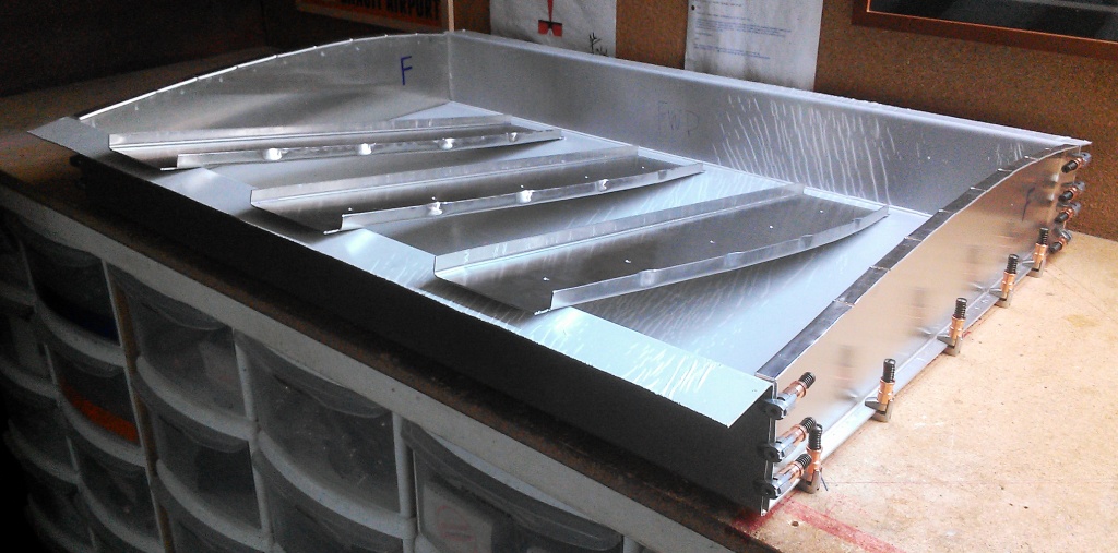

      Looks good, Jake.  Looks very much like mine.  Be sure to leak test it after
      welding.  I used a latex glove as a pressure regulator, and inflated the
      tank by mouth (you don't want more than about 2-3 psi).   After the initial
      weld I found 37 pinhole leaks.  Back to the welder, then tested again and
      found 9 leaks.  Back to the welder again and no leaks.  It's been in service
      now for over 10 years and still has no leaks.

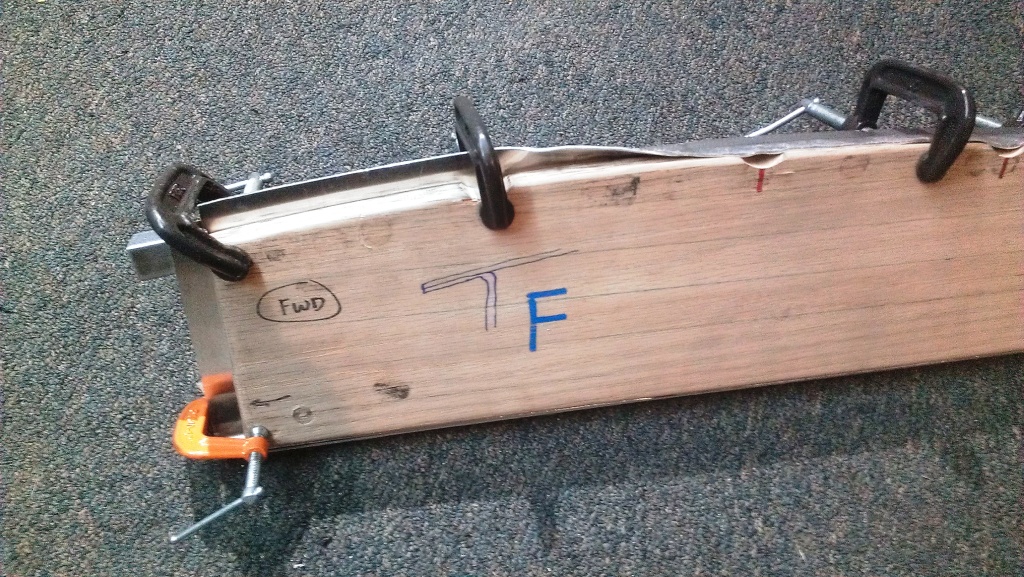

      Hello good Piet-ple,
      A quick update on my project.
      Been working on the fuel tank lately - only one tank that will sit in the
      wing center-section. After a couple false starts it's finally starting to
      come together. I'm making the tank out of 0.063 5052 sheet so it feels like
      I'm building the wing to an RV-7....! (So much for a steel-tube, wood and
      fabric airplane...!!)
      The current plan is for the internal grid to be rivited to itself and the
      external seems to be fully welded - similar in construction to the Stearman.
      Hope you all are enjoying spring...!
