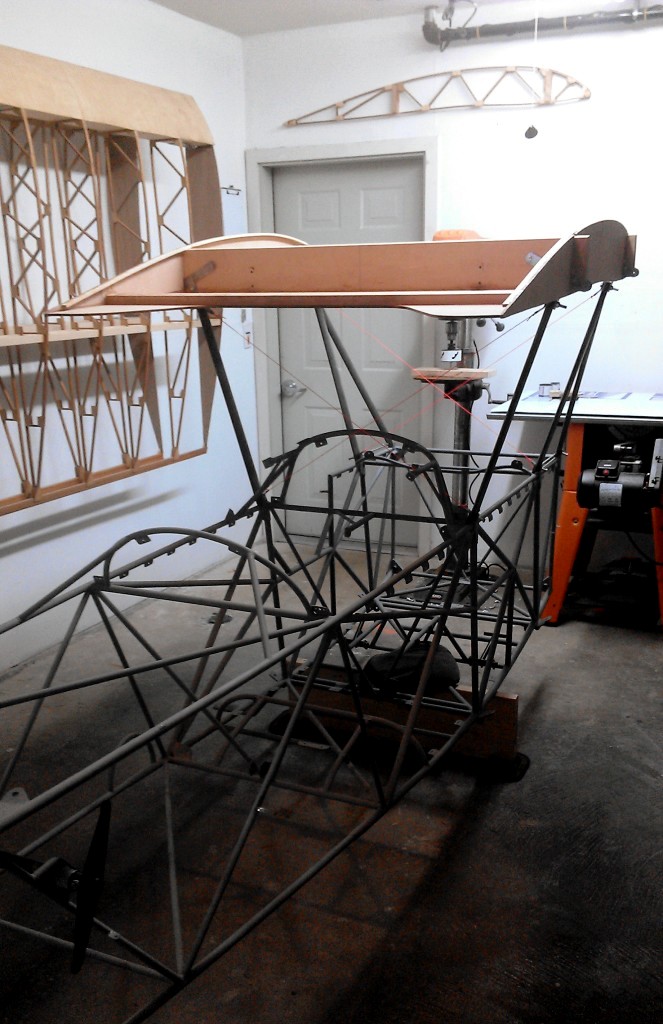

Hello good Piet-ple,
Hope you all are well.....
I consulted with a number of folks regarding my center-section and cabaine struts
and the consensus was that I should modify/angle my cabaine struts outward
to directly tie them to the wing-attach fittings.
So after a weekend of work, I am mostly there. I still need my welder "fill" some
of the bolt holes in the fuselage fittings (and then re-drill them) but the
structural load path is "more correct" (aka WACO, Stearman, etc....)
Never fun to do things over that I thought I had done but it seemed like the right
thing to do and now that it is nearly done I am glad I made the change. Will
be an unusual "look" for a Piet but it's kinda fun that way....
Enjoy your day everyone............

Jake
I know you have a wider center section but others have done vertical cabaine struts
with wider center sections. What was the line of thinking that made "the
consensus [is]... I should modify/angle my cabaine struts outward to directly
tie them to the wing-attach fittings". I ask because I do not see the benefit
from a structural standpoint. Not a criticism, I'm just curious about the decision
path. (I like that part of building).
Also, one thing you learn about Pietenpols is there are very few, if any, new changes
you can think of. For instance this Pietenpol has the angled cabaine struts
too.
http://www.westcoastpiet.com/images/WCP_2013_Gathering/IMG_0595.JPG

Thanks Chris,
Like you said, everything that can be tried has been tried before...!
The thoughts of a friend of mine who is a structural and aeronautical engineer
(and who also owns a Travel Aire biplane and several additional antique planes)
are that the cabaines ending at the fittings would tie the load directly to
them, as opposed to having the load be about eight inches away. He felt that yes,
it would PROBABLY be just fine to have the cabaines vertical, but by canting
the cabaines outward it should make for a better structural arrangement.
There are many, many examples of 1930s era planes with wide center sections where
the cabaine struts are angled outward.

Jake
I did the same as you. A little analysis ( http://home.comcast.net/~mmorrison123/wing_loads.html ) convinced me that with the wider center section, attaching to the end of the center section vice straight up was the way to go for strength. As a result of widening the center section, more lift is carried on the cabanes and less on the lift struts than the standard width center section, but it's a relatively small change. Are you shortening the outer panels to make up for the wider center (that's what I did), or leaving them and going with a longer wingspan?

Actually, since the Pietenpol has the lift struts attaching in the middle of
the wing panels, there are very little lift loads carried by the cabanes
(just the lift generated by the centersection, which is not too much).
The fittings are easier to make if the struts attach at the end of the
centersection spars (ask me how I know).
This is a typical case of one change rippling through the entire airplane.
Just be careful to think it through completely.
