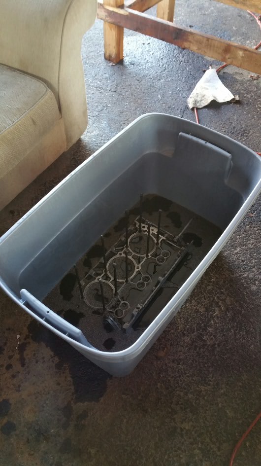

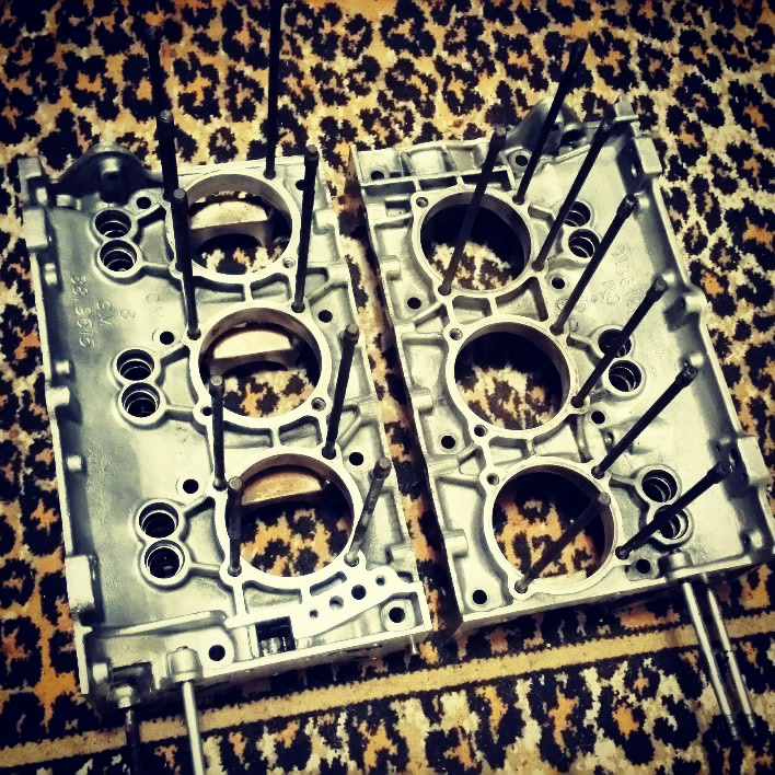

      I used an engine cleaning gun with soap and water to hose off the heavy stuff.
      It was coated in oil, caked in dirt, with aerokroil, wd40, AV30 from disassembly.Then
      soaked it in stoddard solvents, and wire brushed them. Finished with a
      mini dremel with brush attachments and q-tips for the nooks and crannies. I will
      eventually be doing this again when i find another core to disassembly for
      parts.
