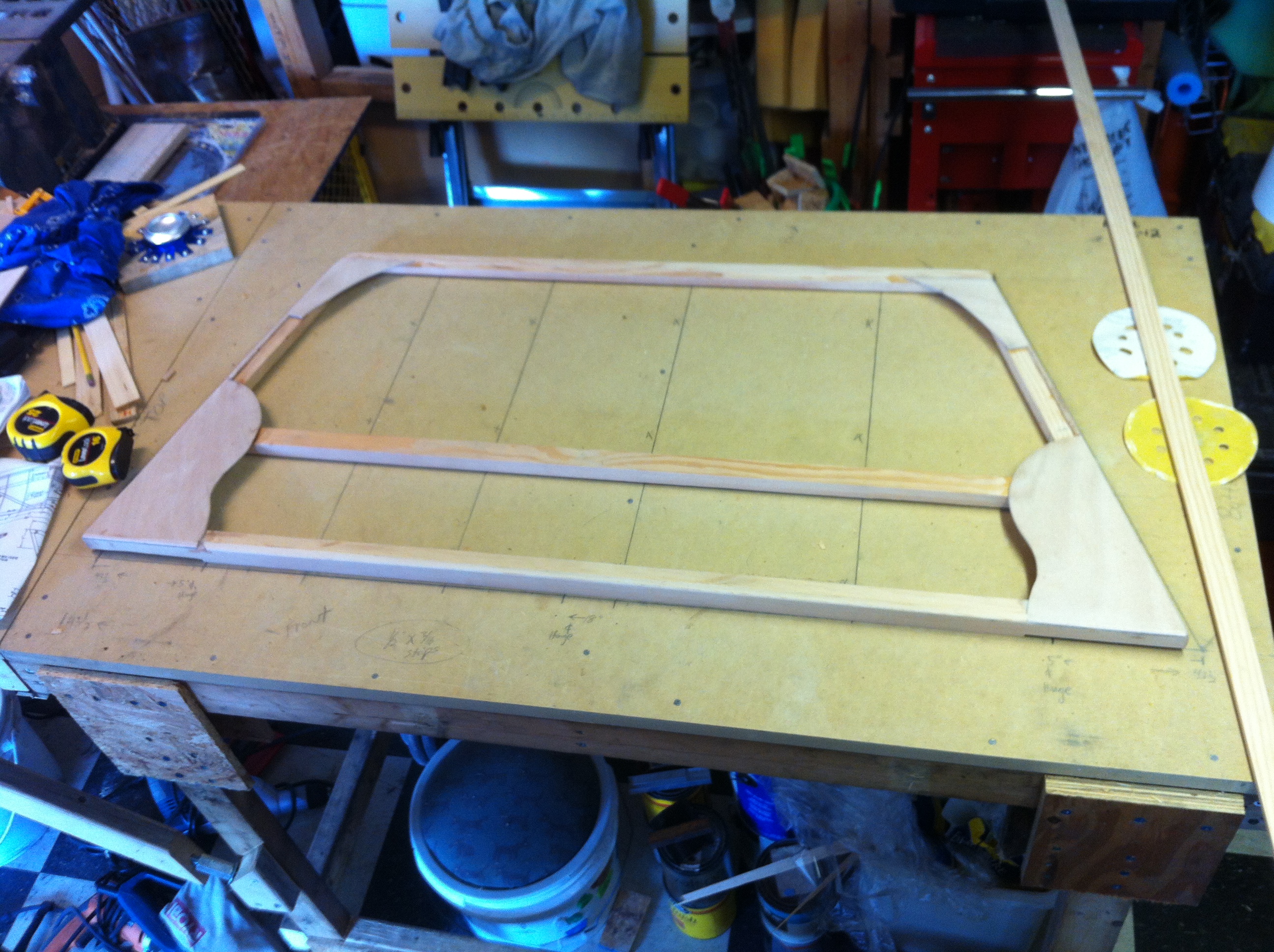

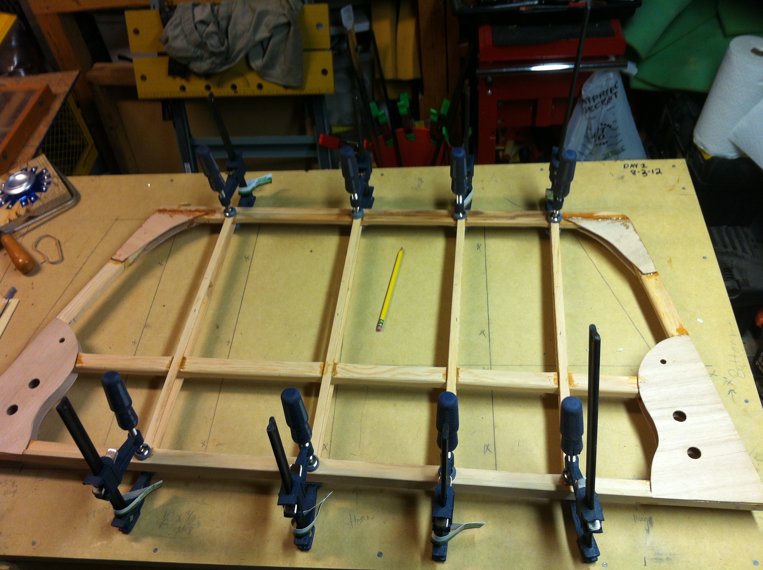

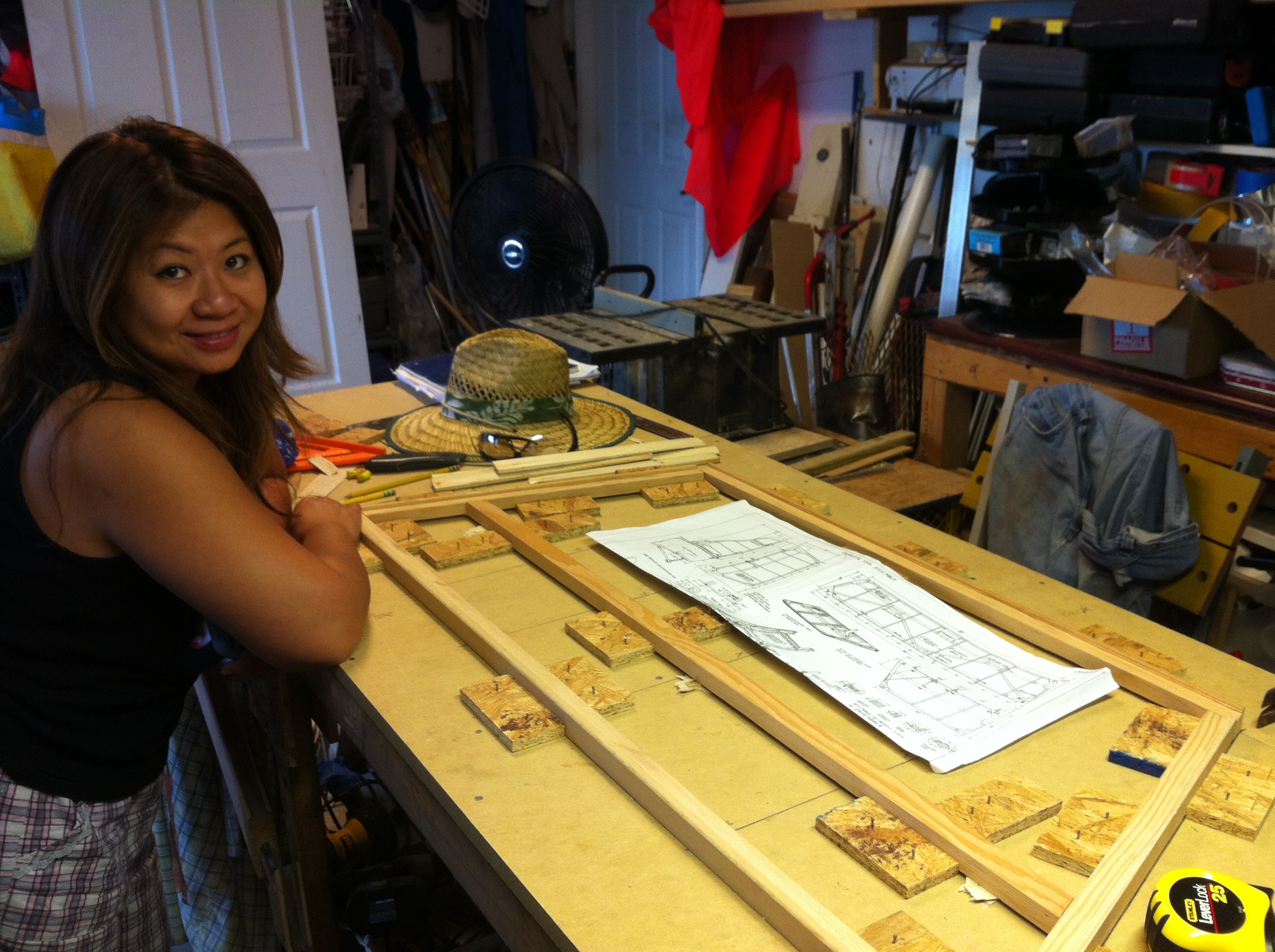

heres the basics..more an overview than step by step. first get comfortable with
your power tools after you've got the bench built, get a framing square, pencil
and wooden blocks. start with an elevator or rudder and just draw out the
part onto the bench and nail or screw down some blocks on the perimeter line you
drew for your part. cut the plywood that ties together the perimeter wood pieces.
t88 it in place using clamps or staples or weights. let set for atleast
6 hours, flip it over and t88 the oposite side plywood bits. then start marking
out, cutting and epoxying in place the interior structural pieces. then the
same with the capstrip pieces. let dry then plenty of sanding to get the shape
you want.
you may want to do all the above with some pine just for practice. if your comfortable
working with a table saw it should all fall into place easily after
looking over the plans for that part several times. if you just concentrate on
one piece at a time it is much less overwhelming.
if the piece is not completed to your satisfaction you can either fix it or
start over .
also one of the pics top left corner shows the bottom of an aluminum soda can
attached to a block of wood. use that with little wood coffee stir sticks to
mix and appktappky t88.
