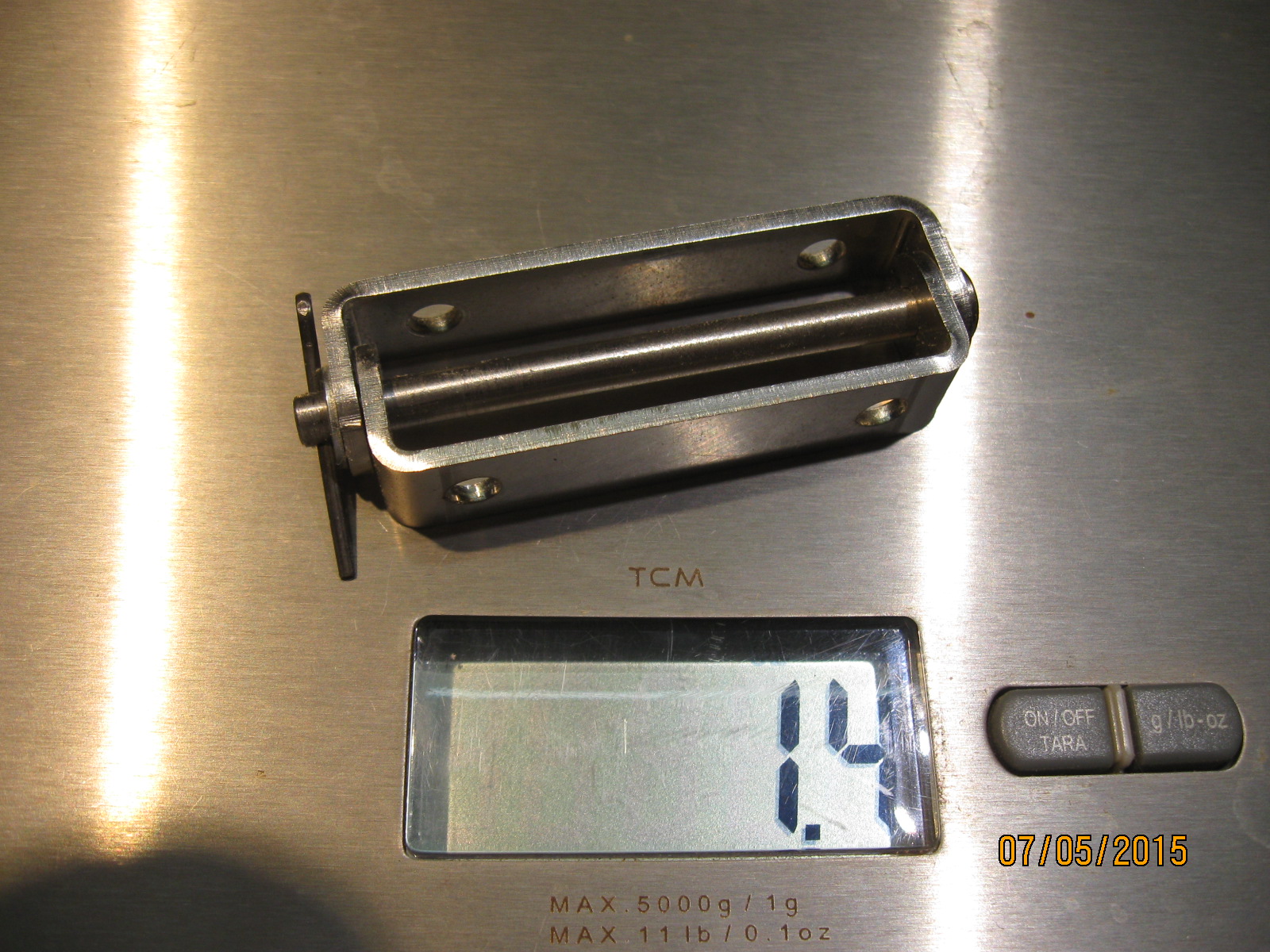

      The photo is from my last Kitlog posting. They are the elevator and rudder hinges.
      Weight is in oz. Material: AISI 304 ss.
      http://forums.matronics.com/viewtopic.php?p=441878#441878
Message 2
| Subject:  | Re: Question re posting progress |
      Photo is from my last Kitlog posting. Elevator and rudder hinges. Complete hinge
      is 1.4 oz. Too heavy? Material is AISI 304 ss.
      http://forums.matronics.com/viewtopic.php?p=441879#441879
      http://forums.matronics.com//files/img_2541_225.jpg

      Nice hinges, though I do not know enough about metallurgy to comment on them
      being SS.

      ss is stainless steel. It is an alooy of iron, chromium and nickel. The variety
      I use is much stronger than mild steel, as used in the early Piets and slightly
      weaker than 4130, which is an alloy of iron, chromium and molybdenum. AISI
      304 is very TIG weldable too. We use about 2000 tons of it per year for our manufacturing.
      Happy landings
      Semih
      http://forums.matronics.com/viewtopic.php?p=441893#441893
Message 10
      I'd say 2000 tons is too heavy.  :)
      I made the same style of hinges, also using T304 stainless steel.  I'll have to
      weigh an assembly to see how much mine weigh.
      Bill C.

      2000 tons have nothing to do with flying stuff. It is just to explain the
      material is readily available to me. Yes, we use about 7-10 tons per day.
      The hinges are laser cut from 2mm (0.08")=8B thick material. When ass
      embled,
      they show almost no sideplay. Personally, I did not like the idea of 3
      eyebolts. I also made more stuff using ss and laser cutting (yes, we have
      our own CNC laser). They are quite different from 1932 fittings. My rudder
      pedals are different too. they are all pedals, no rudder bar, with
      Castamide bearings. Do you have any photos of your hinges?

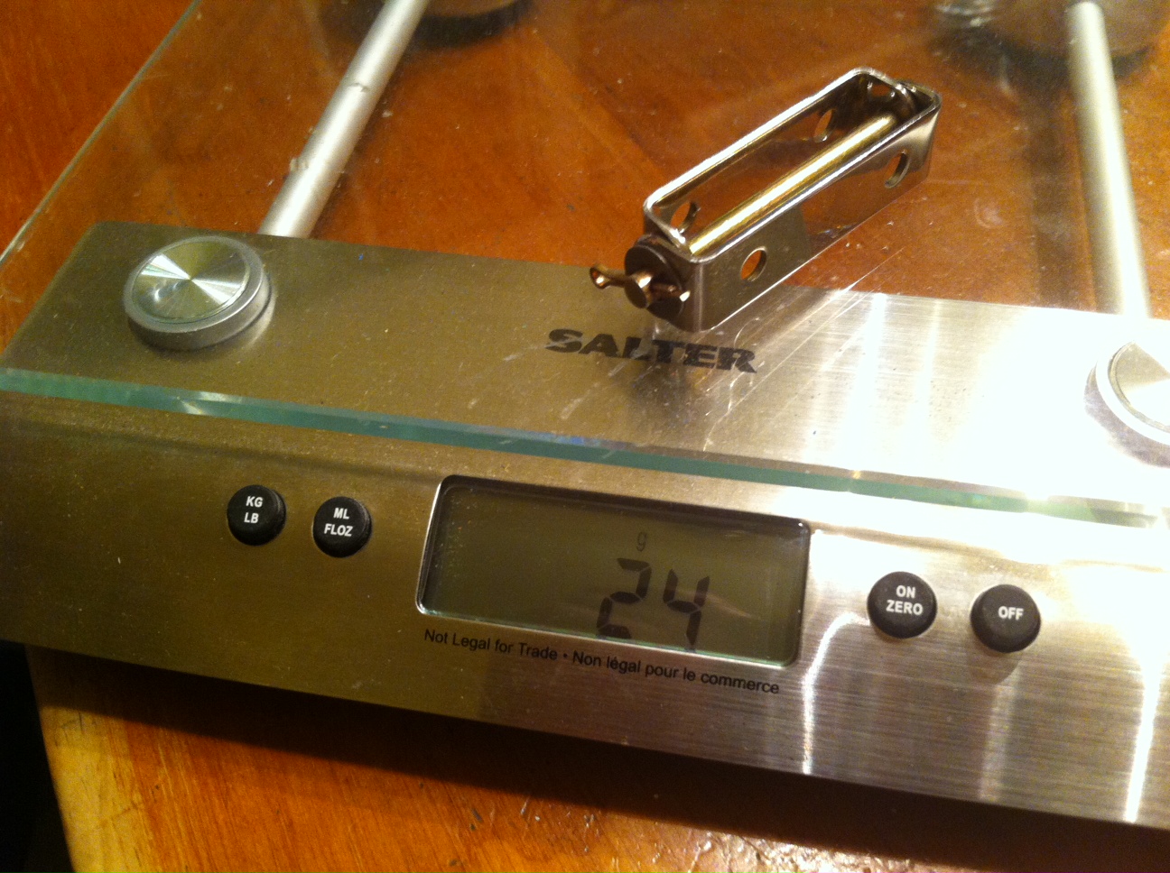

Message 14
      Semih,
      Attached is a photo of my hinge assembly.  As you can see, the weight is 24 grams
      (or about 0.9 ounces), according to my cheap digital scale.  Mine are made
      from 16ga (.058") AISI 304 stainless steel, and I polished them up using a buffing
      wheel and some polishing compound.

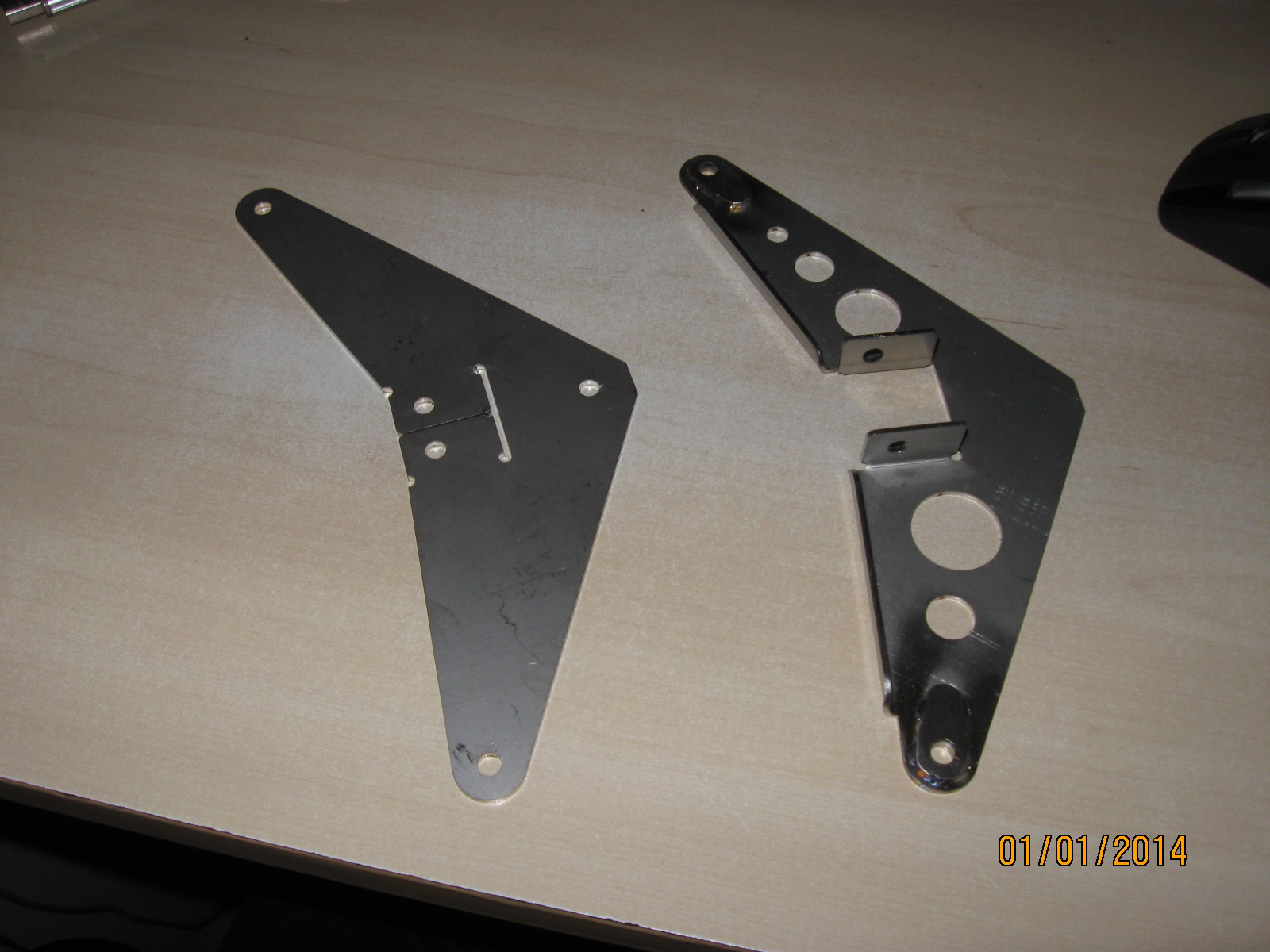

      I have also made a few other fittings from stainless steel, including my control
      horns.  I used the same basic design from the 1932 plans (airfoil shape from
      light gauge sheet metal) but I had the blanks punched out using a CNC punch press
      (+/- .004" accuracy).  Very happy with the results, with the added benefit
      of corrosion resistance offered by the stainless steel.
