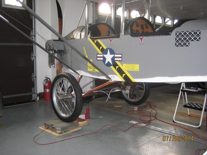

      Paul, I weighed the aircraft last summer to locate the wings. At the time, I had
      everything I could think of in place to get an accurate weight. It came in at
      577#. It now has the permanent diagonals to locate the wings and the aluminum
      cover over the fuel tank. An E.L.T will also be added.
      Once out at a hangar and final assembly is complete, I will do another W&B, but
      it should only change a few pounds. (fingers crossed)
