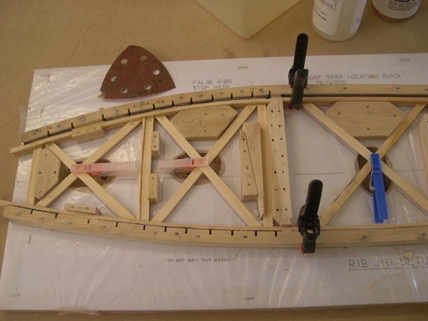

Message 4
| Subject: | Re: Wing Rib Construction |
This form of rib construction has been around for a long time ... just as strong
as a gusset rib if designed correctly. No reason you cannot build a Piet rib
like this, simpler too. Maybe even lighter ... ?
WF2
http://forums.matronics.com/viewtopic.php?p=444219#444219

Message 7
Andy,
I am currently on rib 25 of 30 (or 32 perhaps). I can tell you from my perspective
you are inventing a solution to a problem that does not exist. I can put
together a rib in about 20 minutes (if I did not take small breaks to visit my
son and wife so I do not feel guilty being in the workshop right when I get home!)
I prefabbed 1,100 gussets (4 shapes) in about 4 total hours time from a sheet of
24" x 48" 1/16th aircraft grade plywood. I use a table saw, a chop saw and tin
snips. They sit in 4 plastic containers marked "A" - "D"
I prefabbed the 11 (x 32) rib members using a chop saw with a stop block in about
3 hours total time. These are in 1 gallon zip log bags marked 0-10 (0 being
the nose block)
I use wax paper pieces under the gussets. I made about 1100 of those in about
the same manner as the gussets only I used a 6' straight edge and a razor knife.
I can mix up a batch of Epoxy resin in three minutes.
Assembly is like a an assembly line. I use a razor blade cutter to make minute
trimmings on the rib members to fit the curve of the upper and lower cap strip
as I assemble each rib. Others use a sanding station. Only items 0, 1, 2 8 and
10 require minute trimming to compensate for the curves. each trimming takes
5 seconds.
Despite what some have said, I find the wing rib construction somewhat therapeutic.
I do one per evening 4 nights a week. Sorry I'm almost done.
email me for any info rdewenter@woh.rr.com
Bob 'Early Builder' Dewenter
Dayton OH
WF2,
Three very important words in your statement: "if designed correctly"
However, looking at the photos you supplied and comparing to the Pietenpol rib
design, this method is NOT simpler.
Bill C.
