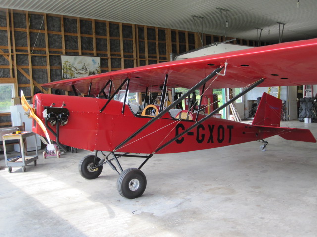

      Hello Everyone,
      Here are a couple of photo's of my Piet.
      It's almost ready for final inspection  :D
      Cheers,
      Patricia

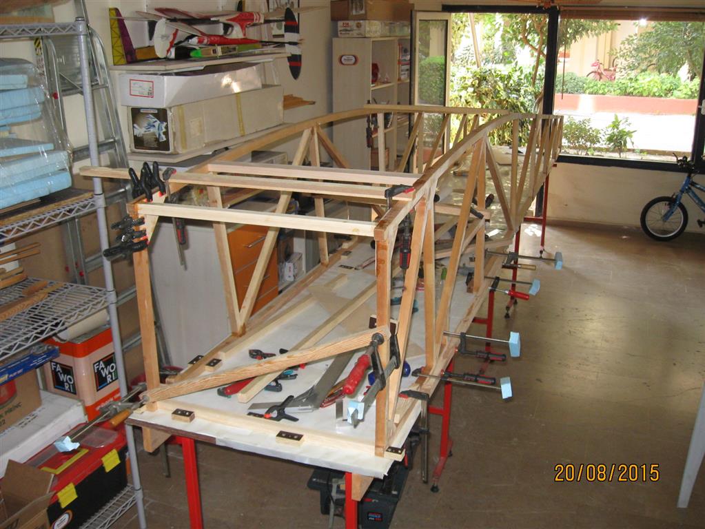

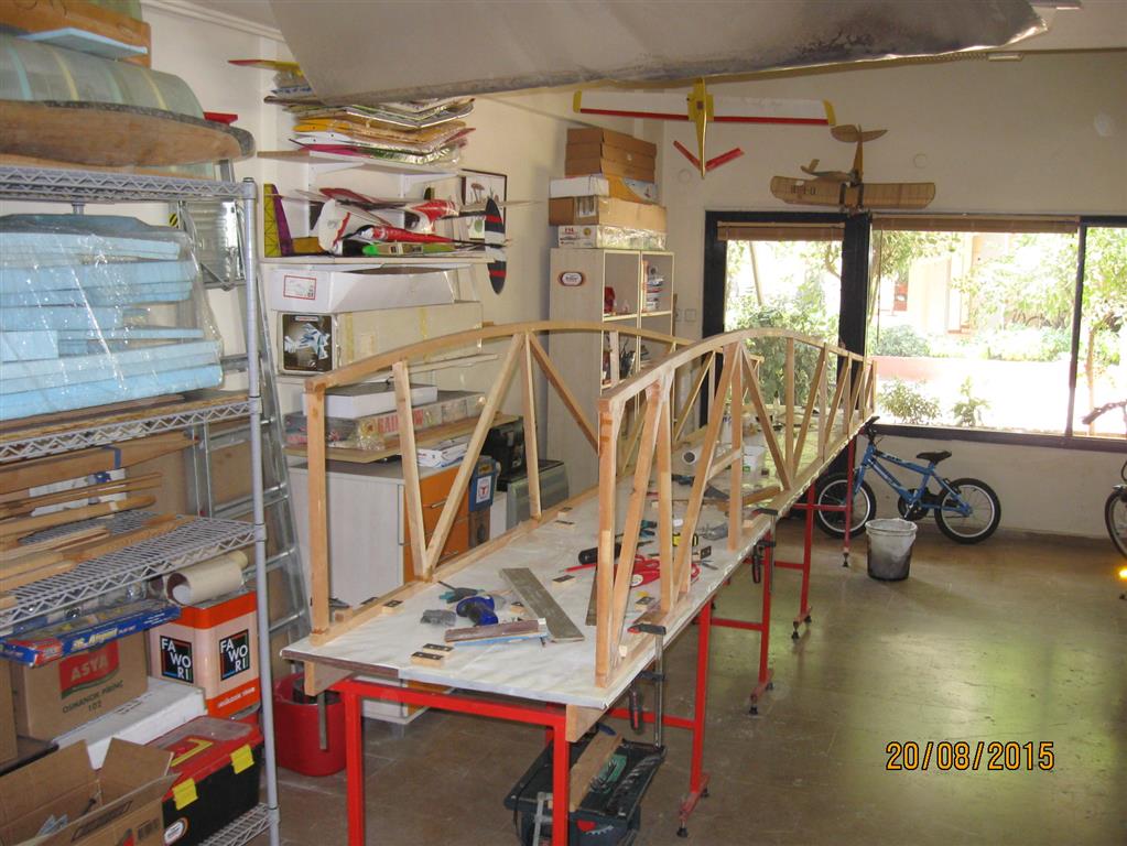

      I (re)started the fuselage. Today, it started to look like a fuselage. I hope within
      a few days, it will look better. Yes, it is wide. Inside width is 600mm
      (about 24 inches).

      OldBird,
      Looking nice, but I do not see the inner gussets - these need to be in place before
      adding your cross members.
      Bob

      It looks very nice.  It appears to be a one piece wing.  Who made the prop? I like
      the shape of it.  What size Cont. engine are you using?  Yes, we all like
      to know the details.
      Good luck with the inspection,
      Scott Liefeld

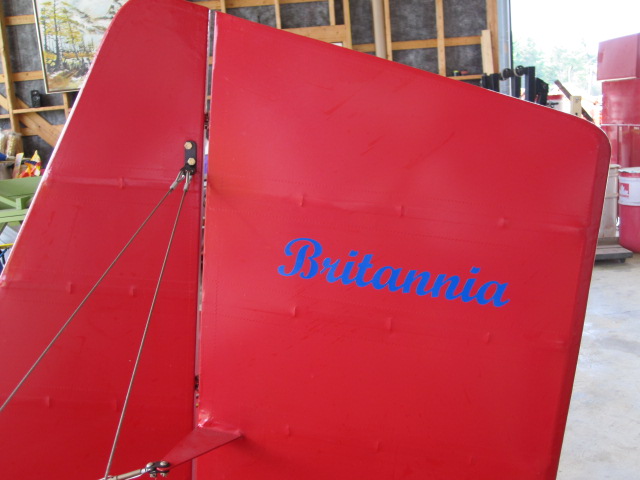

      Your rib stitching looks a bit spartan on the rudder.  AC43.13 is pretty
      specific on stitch spacing.  See page 2-57, here:
      http://www.faa.gov/documentLibrary/media/Advisory_Circular/AC43.13-1b.pdf
      In the slipstream they should be spaced no greater than 2.5" apart (or
      6.35cm for you folks in countries with real measurement systems.)

      Yocum,
      Her Spacing is fine.  The slip stream they are referring to is for the wings. The
      paragraph I placed here is directly from the page you referred and directly
      below the graph.  It is noted for the EMPENNAGE.   There are other publications
      that have the spacing as well.  I used the spacing that the POLY FIBER manual
      indicated and it very much reflects what Patricia has done.
      What ever is written in the covering system manual (this can vary from the different
      processes available) is what should apply to surfaces that are being covered
      with that system.
      "When the lace spacing on the empennage surfaces
      and fuselage, where so incorporated by the original
      aircraft manufacturer, cannot be determined, a
      maximum spacing equal to two times the spacing shown
      in figure 2-12 for the slipstream area on the wings may
      be used".
      You need to read the complete description and not just look at the graph and pictures.
      I am not trying to cause friction but only trying to point you the proper direction.

      I had brought that question up with Dan, in a private email, as that
      distinction had eluded me. I will say, though, and I'm not sure if anyone
      else has noticed, but I have felt my rudder vibrate over 90 mph.
      unfortunately, my poor old neck won't let me turn that far to see what's
      going on. At this point, I'm glad to have the closer spacing.
      Gary Boothe

      Really nice..... gotta love red airplanes!
      Jake Schultz - curator,
      Newport Way Air Museum  (OK, it's just my home)
      http://forums.matronics.com/viewtopic.php?p=446216#446216

      Ah!  You are right!
      That really would have been a wet towel to have to tear down the rudder to re-stitch.
      Probably would have added a couple grand to the total cost of the plane...
      > wings. The paragraph I placed here is directly from the page you referred
      > and directly below the graph.  It is noted for the EMPENNAGE.   There are
      > other publications that have the spacing as well.  I used the spacing that
      > the POLY FIBER manual indicated and it very much reflects what Patricia has
      > done.
      > different processes available) is what should apply to surfaces that are
      > being covered with that system.
      > "When the lace spacing on the empennage surfaces and fuselage, where so
      > incorporated by the original aircraft manufacturer, cannot be determined, a
      > maximum spacing equal to two times the spacing shown in figure 2-12 for the
      > slipstream area on the wings may be used".
      > pictures.
      > direction.
      > Respectfully,
      > Scott Liefeld
