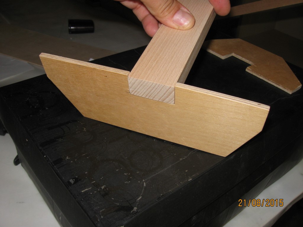

      Bob
      I hope attached photos will help explain what I'm after. I did not like the idea
      of epoxying end grain of wood to outer layer of plywood. I know it will be more
      laborious but I like to saturate end grain with West epoxy, then using micofiber
      thickened West (becomes similar to T-88) to final glue.
      http://forums.matronics.com/viewtopic.php?p=446244#446244
