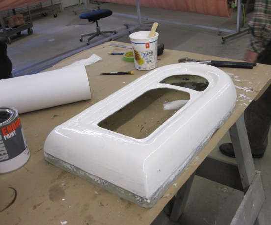

Hi Ray,
The prop is a Cloudcars prop. Engine is a Continental A75
[I bought them both from a friend]
The main cowling is sheet metal .
The nose piece is fibreglass/epoxy laid up over a wooden mold
- so far, several people in this area have used that same mold !
Here are some photo's taken during construction.
-making the template for the sheet metalwork.
-making the cowling and fitting the nosepiece.
-cutting out the openings and finishing work on the nose piece
Cheers,

Patricia,
Very nice work. The cowling looks like it really belongs on this type plane.
Bernard would have been pleased. The A-75 should be a great fit for the pla
ne. Is the motor mount the standard length, or a little longer?
The prop is absolutely beautiful. Maybe someday I will either get one of tho
se same, or carve one. The nose piece was a lot of work, but very nice. I ho
pe I can see your plane someday.
