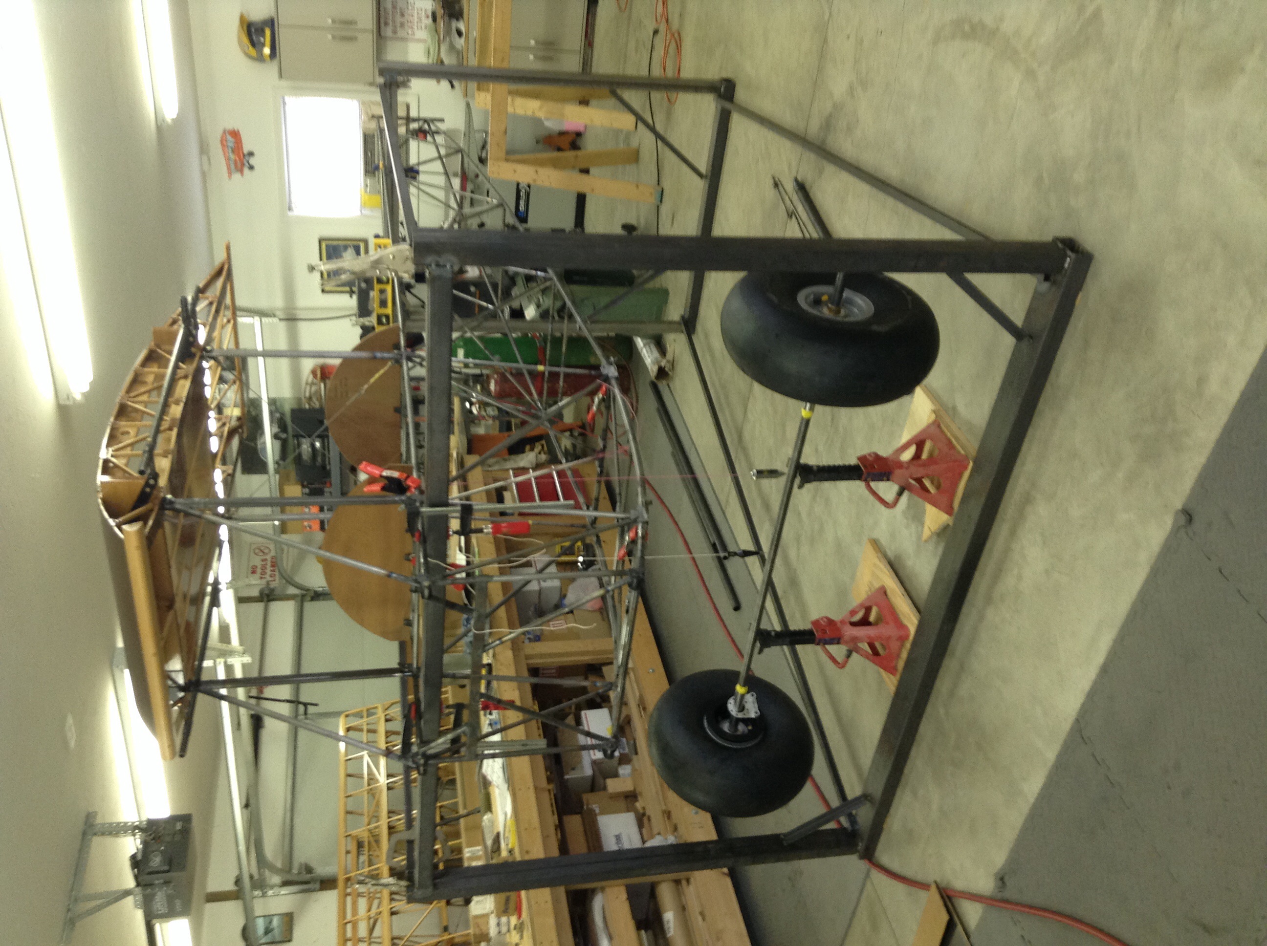

Those are the ones I am using. Almost the exact dimentions as on the plans and
I like them because they are smooth. I think they will give it the right look.
Rob
http://forums.matronics.com/viewtopic.php?p=446328#446328
http://forums.matronics.com//files/image_529.jpg

Hi Rob,
Neat! That looks just right. What wheels and brakes are you using and did you purchase
all if it from Spruce?

Hi Jeff,
I bought the home built Grove 6.00x6 magnesium wheel and disc brake kit from aircraft
spruce and bought the tires and tubes direct from Desser Tire. I think
aired up they were inch taller than on the plans 20" vs 19" if I remember correctly.
I am working on building my landing gear so not sure on the stance when
on yet but in my opinion they are just right for the look I want. Not too big
and not too small. All my measurements are to the plans with steel gear and Model
A engine.
Rob

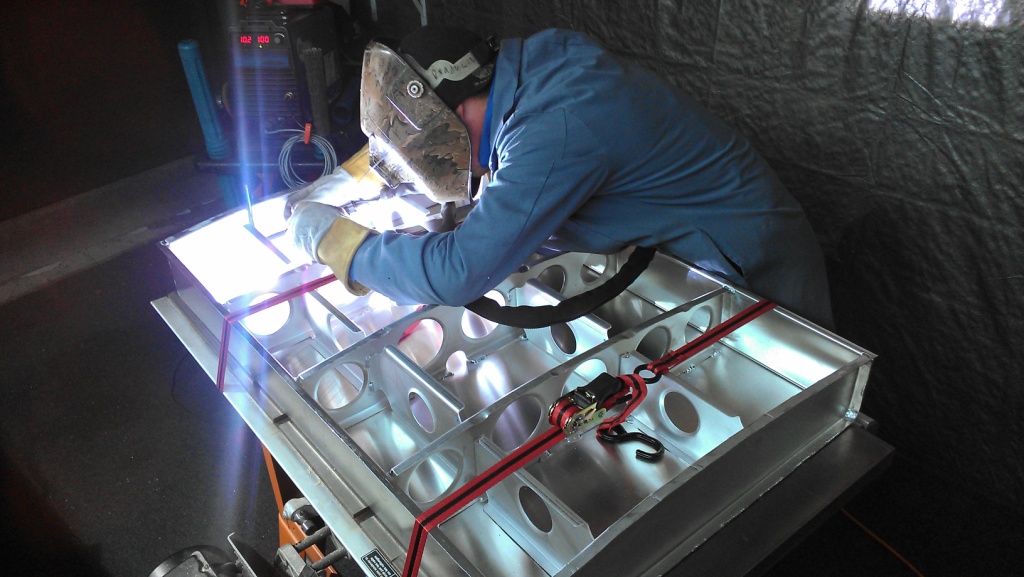

Hello good Piet-ple,
A quick post to share the initial welding of my fuel tank. It is wider than plans
so I only need the single fuel tank in the center-section.
As usual, Mike from Ready Weld makes the welding look easy.
Next step is to fabricate the top skin, fit the filler necks, weld on the sumps/fittings,
and then finish welding the tank.
Jake

How big is it? Looks purdy!
Steve D
