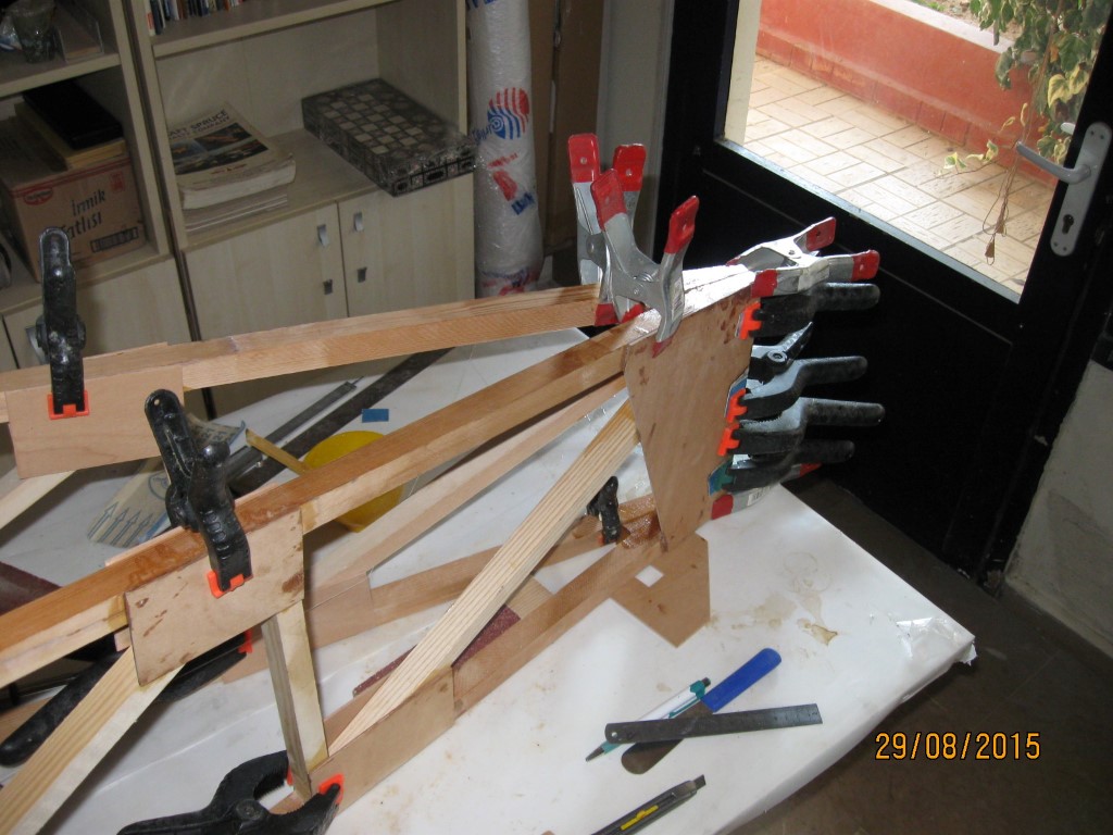

Message 4
| Subject: | Re: TC Pietenpol Progress |
On Saturday, we finished fitting of the tail post and epoxied it.
Today we cut the parts for the rear fuselage cross members. They will be epoxied
this evening. The the diagonals and ply reinforcements. Hoping to remove fuselage
from the bench this week to work on the details.
http://forums.matronics.com/viewtopic.php?p=446559#446559

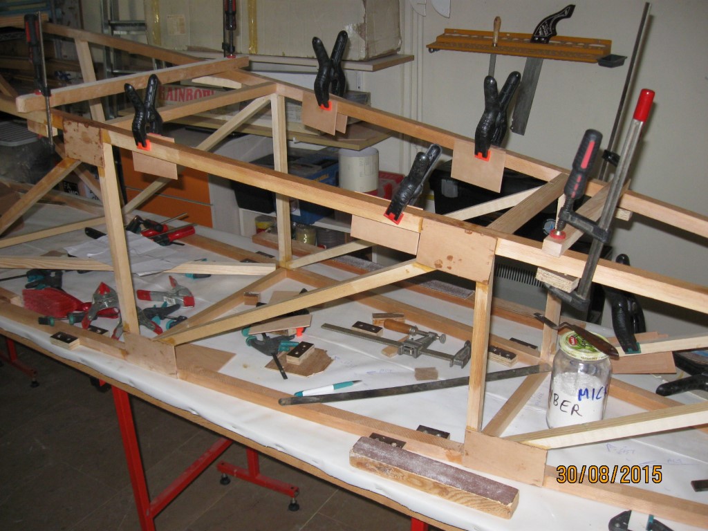

Message 5
http://forums.matronics.com/viewtopic.php?p=446560#446560
http://forums.matronics.com//files/img_2873_medium_156.jpg
http://forums.matronics.com//files/img_2869_medium_164.jpg
http://forums.matronics.com//files/img_2867_medium_141.jpg
