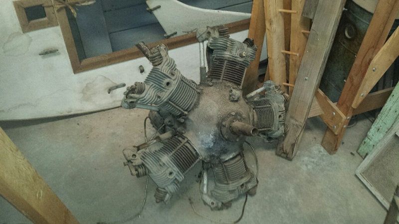

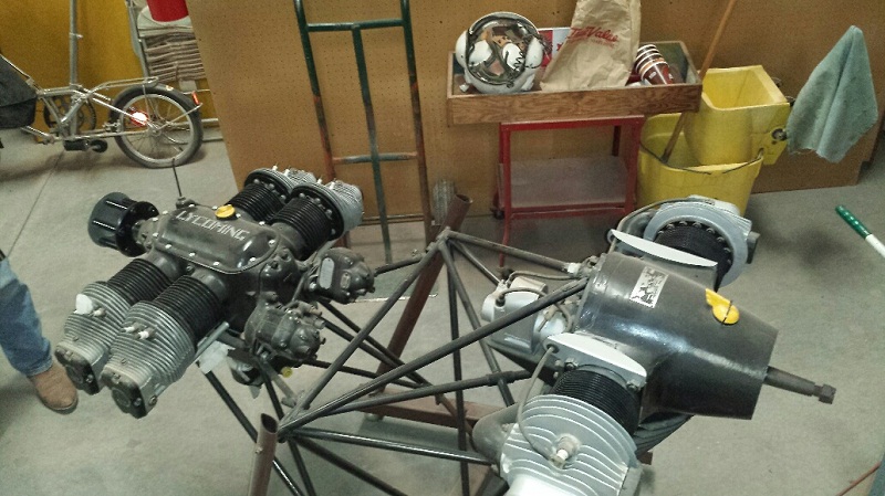

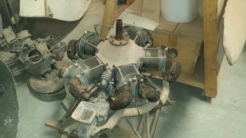

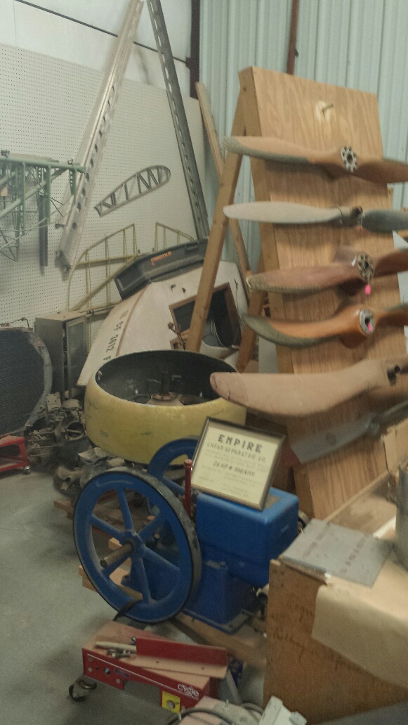

We didn't get a chance to weigh the engines today. We're going to have to move
a bunch of stuff out of the way to make room for the scales. But I did take some
pictures.
These all belong to a friend of mine who's going to handle the engine and steel
parts for the project. I'll be the wood guy. ...I think I have the easy job ;)
*it looks like these pictures are going in reverse order, must be a matronics thing
Isous Christos, Theou Yios, Str
http://forums.matronics.com/viewtopic.php?p=446835#446835
http://forums.matronics.com//files/props_793.jpeg
http://forums.matronics.com//files/warner_106.jpeg
http://forums.matronics.com//files/lycoming_and_aeronca_181.jpeg
http://forums.matronics.com//files/lambert_open_rocker_208.jpeg
http://forums.matronics.com//files/lambert_209.jpeg

Oops, sorry guys, I got drool all over these pictures.
