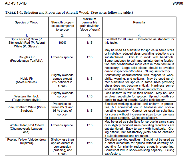

    Hey all, For those of you with lots of experience, what are some of the best and most available woods for rib capstrips? Douwe

    Other than spruce? I used Poplar. Sent from my iPhone > On Sep 14, 2015, at 11:29 AM, Douwe Blumberg <douwe@douwestudios.com> wrot e: > > Hey all, > > For those of you with lots of experience, what are some of the best and mo st available woods for rib capstrips? > > Douwe > > 3D=3D=3D=3D=3D=3D=3D=3D=3D=3D=3D=3D=3D=3D=3D=3 D=3D=3D=3D=3D=3D=3D=3D=3D=3D=3D=3D=3D=3D=3D=3D =3D=3D=3D=3D=3D=3D=3D=3D=3D=3D=3D=3D=3D=3D=3D 3D=3D=3D=3D=3D=3D=3D=3D=3D=3D=3D=3D=3D=3D=3D=3 D=3D=3D=3D=3D=3D=3D=3D=3D=3D=3D=3D=3D=3D=3D=3D =3D=3D=3D=3D=3D=3D=3D=3D=3D=3D=3D=3D=3D=3D=3D 3D=3D=3D=3D=3D=3D=3D=3D=3D=3D=3D=3D=3D=3D=3D=3 D=3D=3D=3D=3D=3D=3D=3D=3D=3D=3D=3D=3D=3D=3D=3D =3D=3D=3D=3D=3D=3D=3D=3D=3D=3D=3D=3D=3D=3D=3D 3D=3D=3D=3D=3D=3D=3D=3D=3D=3D=3D=3D=3D=3D=3D=3 D=3D=3D=3D=3D=3D=3D=3D=3D=3D=3D=3D=3D=3D=3D=3D =3D=3D=3D=3D=3D=3D=3D=3D=3D=3D=3D=3D=3D=3D=3D >

    Douwe Cedar Dale ----- Original Message ----- From: Douwe Blumberg To: pietenpol-list@matronics.com Sent: Monday, September 14, 2015 1:29 PM Subject: Pietenpol-List: best wood for capstrips Hey all, For those of you with lots of experience, what are some of the best and m ost available woods for rib capstrips? Douwe --- This email has been checked for viruses by Avast antivirus software. https://www.avast.com/antivirus

    AC 43.13 -------- Semper Fi, Terry Hand Athens, GA Read this topic online here: http://forums.matronics.com/viewtopic.php?p=447064#447064 Attachments: http://forums.matronics.com//files/screen_shot_2015_09_14_at_114527_am_510.png
