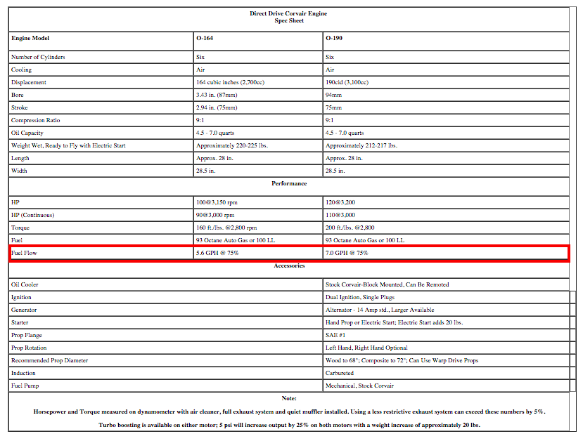

I believe that it's around 5.5 gph.
Rpm will vary on propeller choice.

The chart below comes from William Wynne's website, www.FlyCorvair.com. It is a great source of information about the Corvair engine. In addition you can read his blog at www.FlyCorvair.net.
One last source of info should you decide on the Pietenpol/Corvair combination is the forum dedicated to the "Pietvair" - http://pietvair.freeforums.net/
