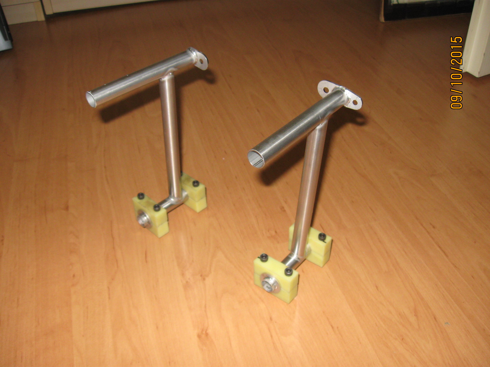

Thank you Ray. In fact, yes, I did. But there are other factors: I am a
mechanical engineer and a (good) practical mechanic. The welds were made by
one of my student technicians (the best actually). I used to build violins
hence the woodwork. I have to admit that I had to rework some parts,
because I let my woodworking apprentice homebuilders do some of the job.
But that's life. You learn from mistakes, don't you?=8B They got much
better
now, so I (sometimes we) cqan work faster. Since I am a full time employee
at the age 67, I only have weekends but metal work is done where I work, it
is a bonus.
Semih
