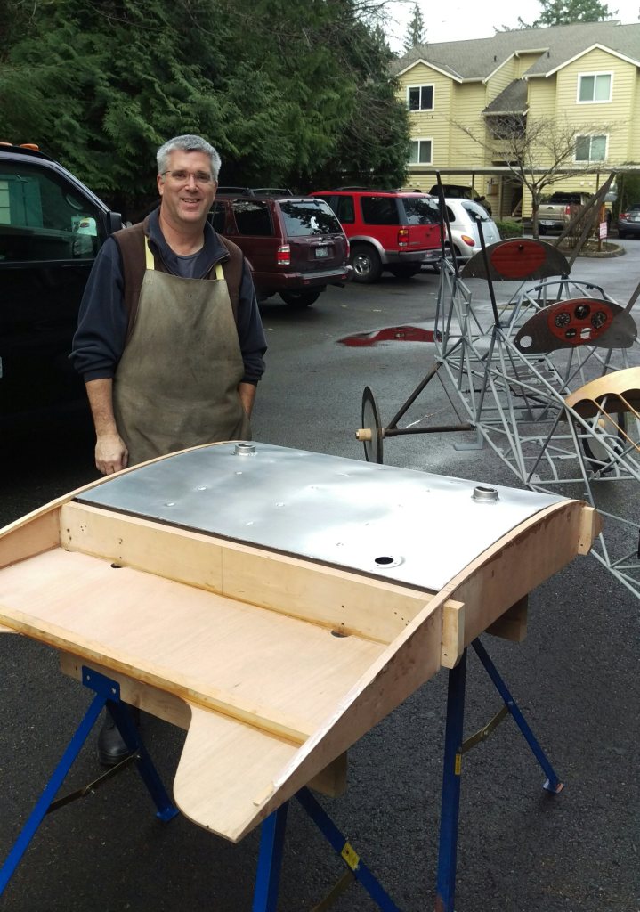

Hello good Piet-ple,
Hope you all had a good holiday break....!!
Had a chance for Mike from "Ready Weld" to stop over and finish up the welding
on my fuel tank. I next have to install the sumps and pressure test the tank -
then I can move on to more work on the center-section. I never thought the tank
would take so long, but I have sure learned a lot....!!
Details: Tank is .063 5052 Aluminum, weighs 21 pounds without the sumps, should
hold about 20 gallons to allow for about 2 1/2 hours + 30 min reserve. (see
older posts for the internal structure and more details)
Gotta love the rainy weather (aka "airplane building season")
Jake

The tank looks great. Too bad you have to cover it up.

Sure is beautiful. Wish I could have seen your build the last time we were in Seattle,
but the Duck crash put that out of the question. Hope to get a visit in
the next time I'm there. Keep up the beautiful work, it is inspirational.
