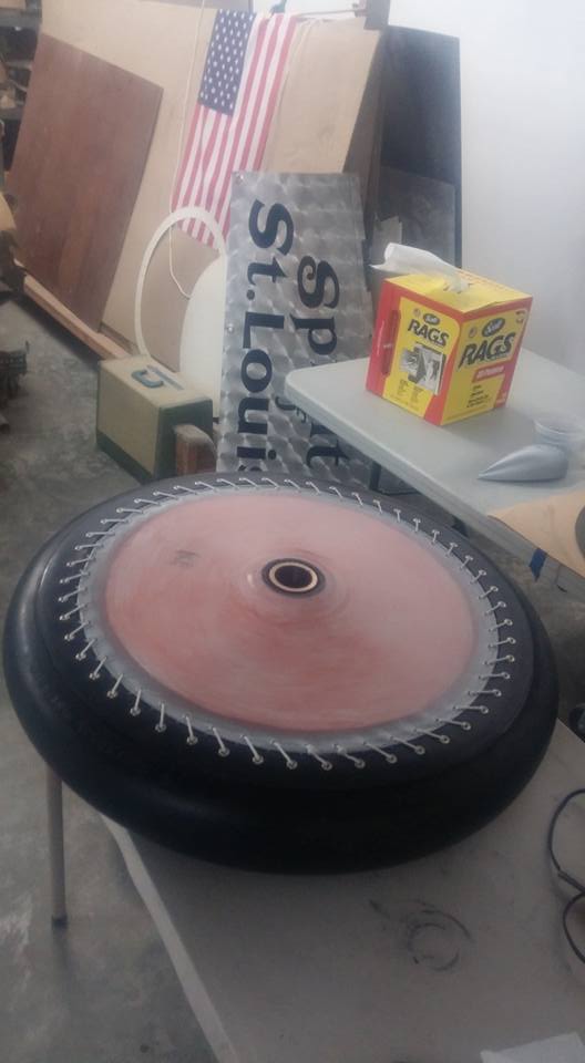

      Here's a photo I found, of the wheel covers on the Old Rhinebeck Aerodrome's Spirit
      replica that recently took to the skies.  I believe a flat ring of rubber
      is prepared with grommets, and then bonded to the sidewall of the tire.  This,
      then creates a flange to attach the covering fabric to.  I believe this is the
      way it was done on the original.  Pretty neat.

      Thanks for additional info guys!

      OH! I like that look. Could even be used to disguise motorcycle mag wheels.
