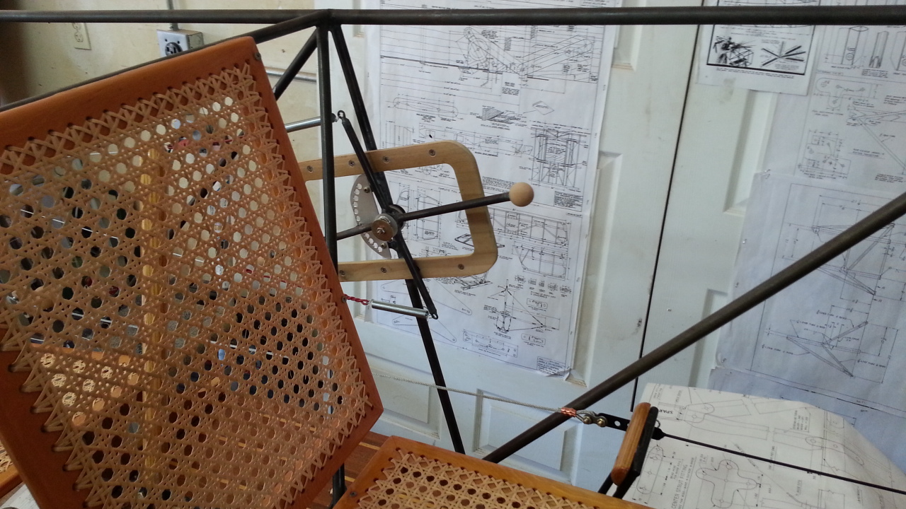

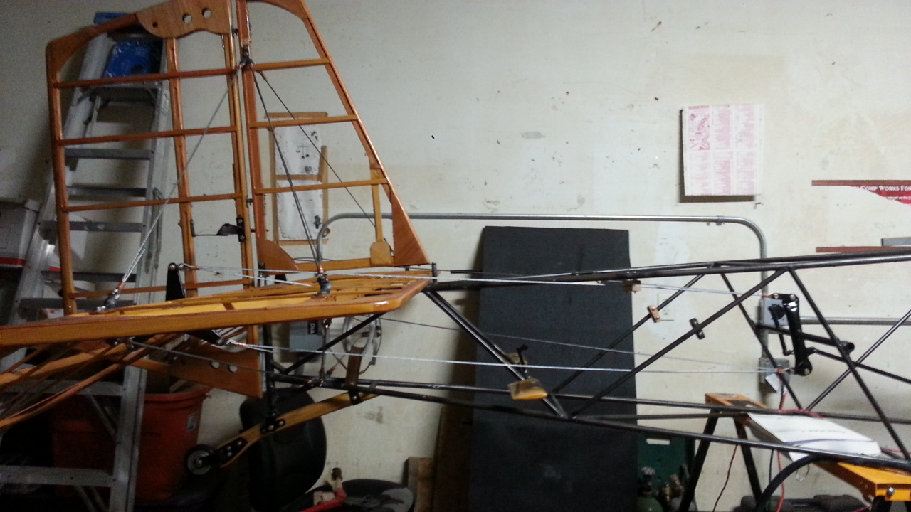

      I was originally planning on installing the flipper further aft but the tailwheel
      bungee would interfere. I also have a spring assist trim system that connects
      to the torque tube. I got carried away. the flipper is more of a conversation
      piece. i wanted to keep the idea alive. not many people have heard of it. the
      small handle along the seat is for adjusting the flipper and the other one
      for the bungee system.
