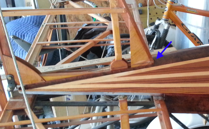

Paul,
Nice work. The only question I have is about vertical stab offset. Here is a link
to an earlier discussion of the topic, so you will understand what I am getting
at-
http://forums.matronics.com/viewtopic.php?t=92890&highlight=vertoffset
It appears that you may have some offset already built in, but you do not have
the ability to adjust your vertical stabilizer (see screenshot). Did you already
put in some offset, and, if so, how much? How do you plan to adjust it if it
is too much/not enough?
Like I said, really nice work. Just that question.

Hey Terry. its about 3/4 offset I think. there is about 1/4 inch additional wiggle
room. need to break out the sander if even more is required.
Paul Donahue
