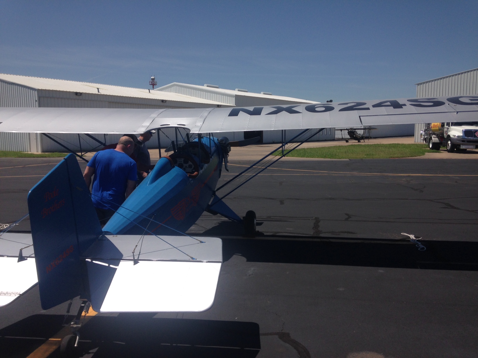

> Nice day at KLNC. We had Lunch and then flight..3rd GN-1 fella flew formation
w/us,
> but in his Cherokee. I suppose we could call it a fly in..
> KLNC
> A65-8
> N2308C
> Slick 4330's
> AN Hardware
> Airframe 755TT
> W72CK-42 Sensenich
> Standard Factory GN-1
> http://forums.matronics.com/viewtopic.php?p=455909#455909

> I like the look of the silver on the wings and tail surfaces of Four-Sierra-Golf.
> The day looks like it was fun!

yes, Sierra Golf has an 0-200 and an electrical sys, while mine is an A65 and none.
We seemed to have about the same cruise speed though, but of course when
we took off together, he climbed a bit better. Pic's were all cellphone photos.
I had gopro shots of SG inflight, but no zoom lense..it was a bit shakey.
