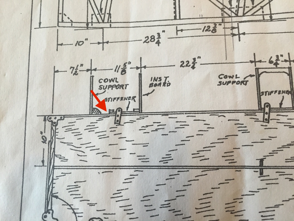

I see that many attach the forward cowl support to the leading edge of the front
stiffener. The plans call for this piece to be attached to the fuselage a few
inches ahead of the stiffener as indicated in the drawing. Why is this done?
John

| Subject: | Re: Cowl Support |
John;
My airplane (and, I suspect, others with a nose tank) does not have that cowl support
because the nose tank occupies that space. I have a top cowl piece that
goes from the front 'instrument board' to the firewall and that cowl piece has
the front cockpit windscreen on top of it.
The stiffener goes across the top longerons where the lower ends of the cabane
brace struts attach to the longerons. I don't think there is anything magical
about where the 'cowl support' attaches but I could be missing something. Builders
with a wing tank might have a better answer for you.
Oscar Zuniga
