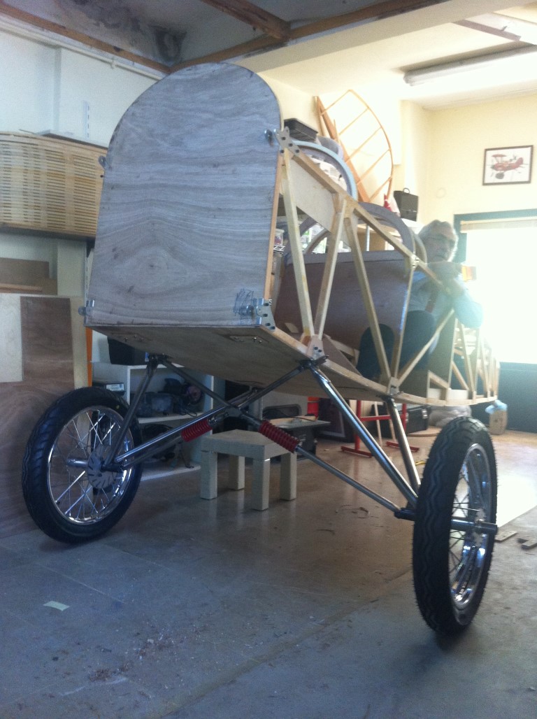

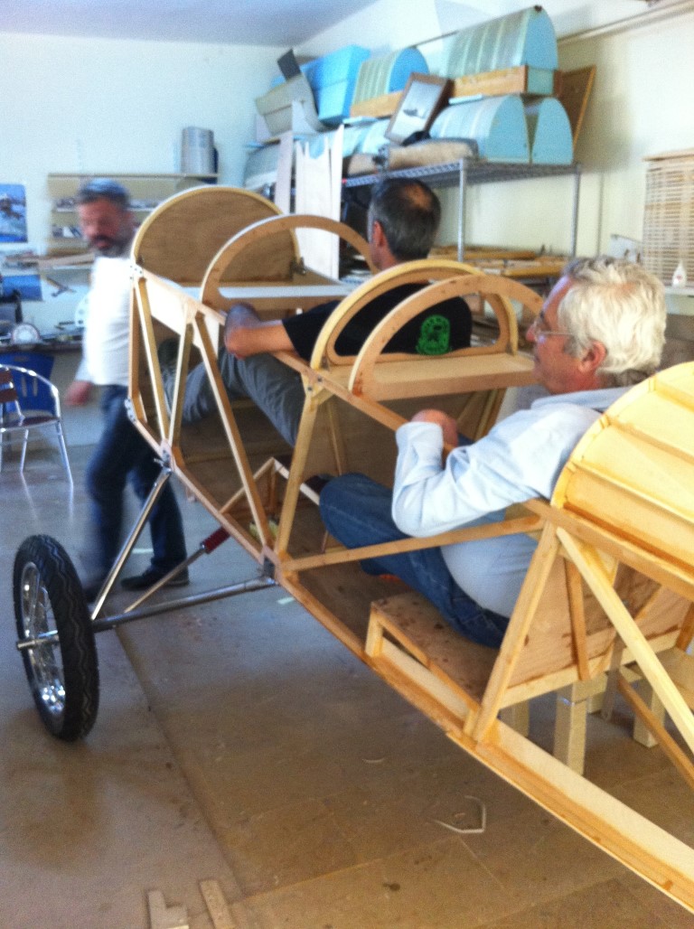

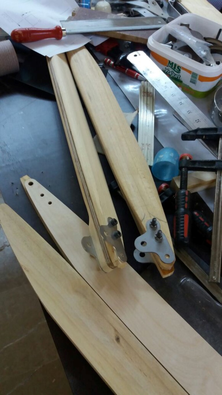

      I have not posted any progress for a long while. This doesn't mean that I wasn't
      active. Fuselage is on its wheels now, almost finished with the turtledeck,

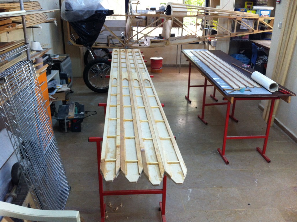

      I finished the wing spars, they are plywood/wood, some of the cabane struts and
      lift struts are finished, some still wait to be shaped. Thet are all plywood,

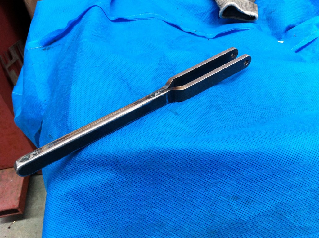

      carbon, wood. It is not that I don't like aluminum or steel, the reason is they
      are simply not available here. I also designed a tailwheel with angle release.
      I didn't make it yet. In a few weeks, I am hoping to put the wings together.
      Ribs were ready years ago.

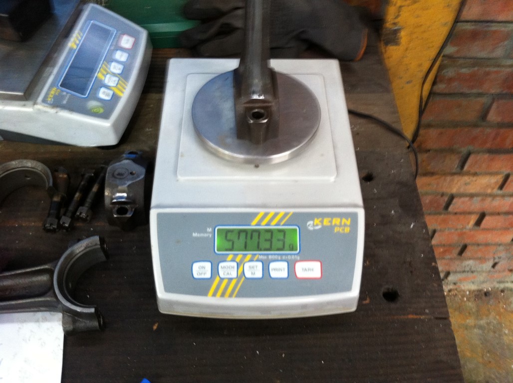

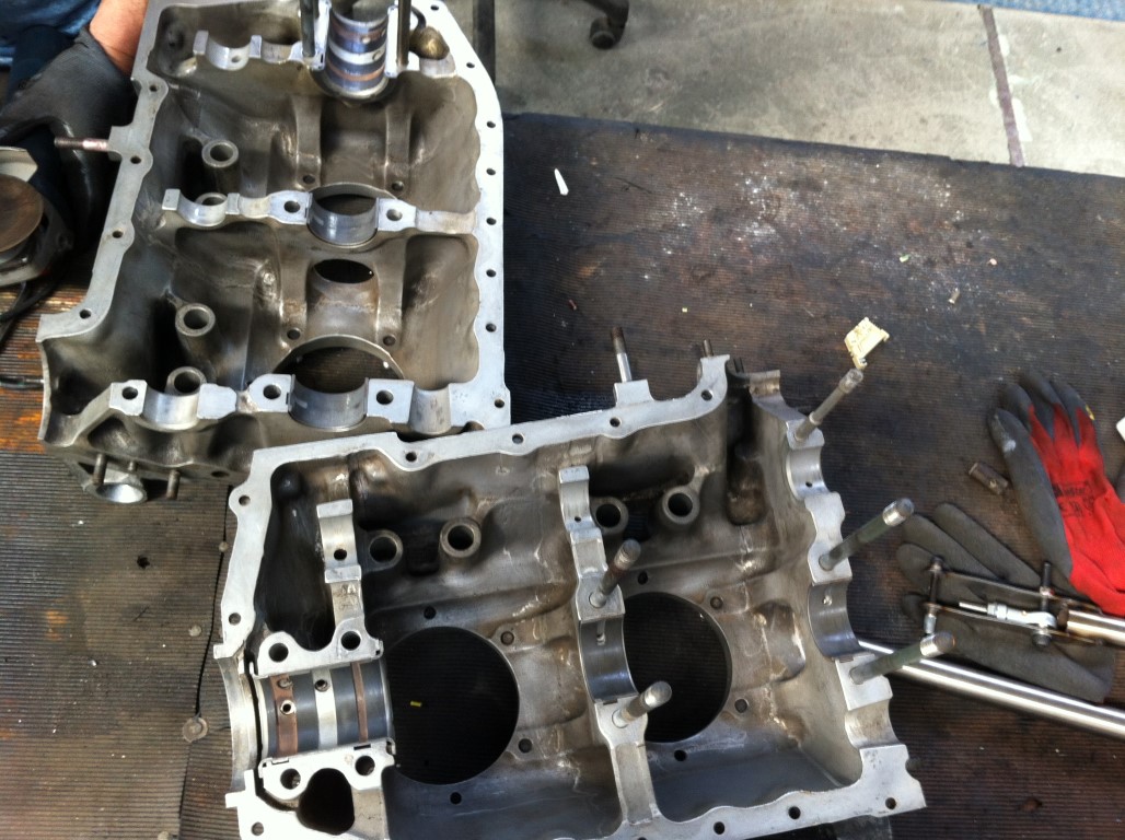

      Engine: C90-8F. I had an A65-8 originally. A few months ago I found a C90-8F from
      a junkyard. Bought it and started working on it. I completely disassembled
      and cleaned whatever came. Now I am at the stage of putting it together. I weighed
      the conrods and found differences as much as 1/3 ounces on the opposing ones
      (ie. 1-2 and 3-4). I balanced them down to 0.01 grams (0.00035 ounces). I
      will do the same for the pistons and hope for an engine with less vibration. I
      will not use shellack on the crankcase. I will use Loctite 518. I will also use
      the silk thread. I made two test pieces, one with shellack and one with Loctite,
      definitely Loctite is better. Bad luck, it wasn't available 70 years ago.
      I also made a jig for the engine mount. I made the parts and cut the tubing.
      I hope to start next week.

      Semih; as usual, your workmanship looks very pleasing in all respects.  It will
      be a beautiful airplane.  As for shellac, the oil gallery plugs on the front
      of my engine were installed with shellac as per the Continental manual and at
      the annual inspection I found one of them weeping oil just a bit and the other
      one not tight in its threads.  As to using Loctite on the case seam, I am not
      an A&P and do not know what constitutes acceptable methods, but I'm with you...
      we have far better materials available today than shellac.
