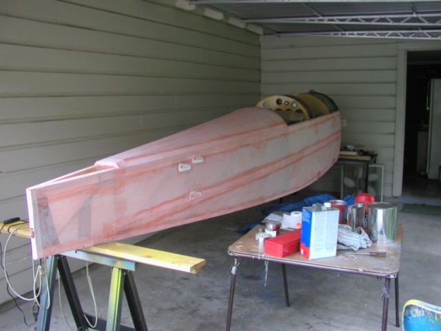

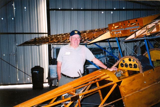

    John; I've never built the turtledeck myself, but I've built similar things and I would have to agree with what Chris Tracy and others wrote... the best shot you'll have at it is to build the front and rear supports and then stretch some strings or thin slats between those stations to develop the lines of it. If you try to work your way aft, it'll probably end up being wavy or bumpy. I'll try to attach two pictures of how the turtledeck went together on 41CC, but you'll find that everybody has a different notion of how it should look. On 41CC, the stringers come together at the tail in a flat shape so as to fair into the horizontal stabilizer. Some make theirs rounded instead. You'll also notice that the stringers on 41CC have to twist on their way aft, so there are little 'holders' on the intermediate sections to hold them in their proper positions. The foam and glass guys would ask, why bother with all that fuss? Stick some slabs of blue or pink foam on the aft fuselage, get a 4' long piece of 2x4 and glue some 40 grit floor sanding paper onto it, and sand the foam to shape in about 15 minutes. Shop vac all the sanding dust off. Glass over it, remove the hardened turtledeck, dig out the foam, done ;o) -------- Oscar Zuniga Medford, OR Air Camper NX41CC &quot;Scout&quot; A75 power, 72x36 Culver prop Read this topic online here: http://forums.matronics.com/viewtopic.php?p=462945#462945 Attachments: http://forums.matronics.com//files/tdeck2_186.jpg http://forums.matronics.com//files/tdeck1_456.jpg
