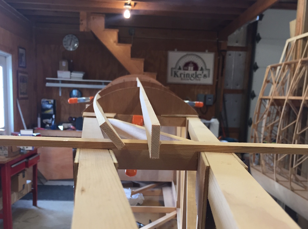

      The turtle deck was my first bug challenge on the airframe.  Turned out well and
      fairly easy.
      I used a CAD program form emachines.com to draw the front support.  I used 9 slats
      (1/4" x 1/2").  I don't know how to describe this exactly, but in my experience,
      the two middle supports are "basically copies of the front support".
      Once I had my front support made, I just "transferred" the layout to progressively
      smaller "shorter" support  panels.
      I got the rough dimensions for the two middle supports from measuring the top of
      the stringer to the fuselage "cross member"

      Thanks for the suggestions.  I have not abandoned my first attempt at this yet
      with scrap pieces of plywood as supports.  This is starting to look pretty good
      to me now.  Does anyone see any problems with this?
      John Francis

Message 5
| Subject:  | Re: Turtle Deck Help! |
      John,
      The bottom line is do what looks good to you. On the other hand, when
      planes with turtle decks are judged at Oshkosh, the judges look down the
      stringers to make sure the are perfectly straight. They are looking for
      stringers that have no bows in any direction. It can be done, but is
      more difficult to lay out and perfect. See the attached photos.
      Rick Schreiber

Message 6
      John;
      It does seem to be taking on some pleasing lines!  And I realize that you're just
      getting underway with it, but if you'll look at the image "tdeck1" that I sent,
      that piece of plywood over the stringers just aft of the rear seat back is
      very important.  I rest the palm of my hand right there every time I get out
      of the cockpit, and if the plywood wasn't there, I would be pushing on the fabric
      and not much else.  You don't have to scallop the aft edge of the plywood,
      but I think the scalloping helps the fabric lay down smoother and not form a
      visible ridge where the plywood ends.
      Oscar Zuniga
      Medford, OR
      Air Camper NX41CC "Scout"
      A75 power, 72x36 Culver prop
      http://forums.matronics.com/viewtopic.php?p=462969#462969
Message 7
      I haven't glued anything in yet.  I was going to add the piece of plywood behind
      the headrest last.  Tomorrow I will start over from the front.  I am not familiar
      with cadcam programs so will do it the old fashion way...with strings.
      John Francis
      http://forums.matronics.com/viewtopic.php?p=462970#462970
