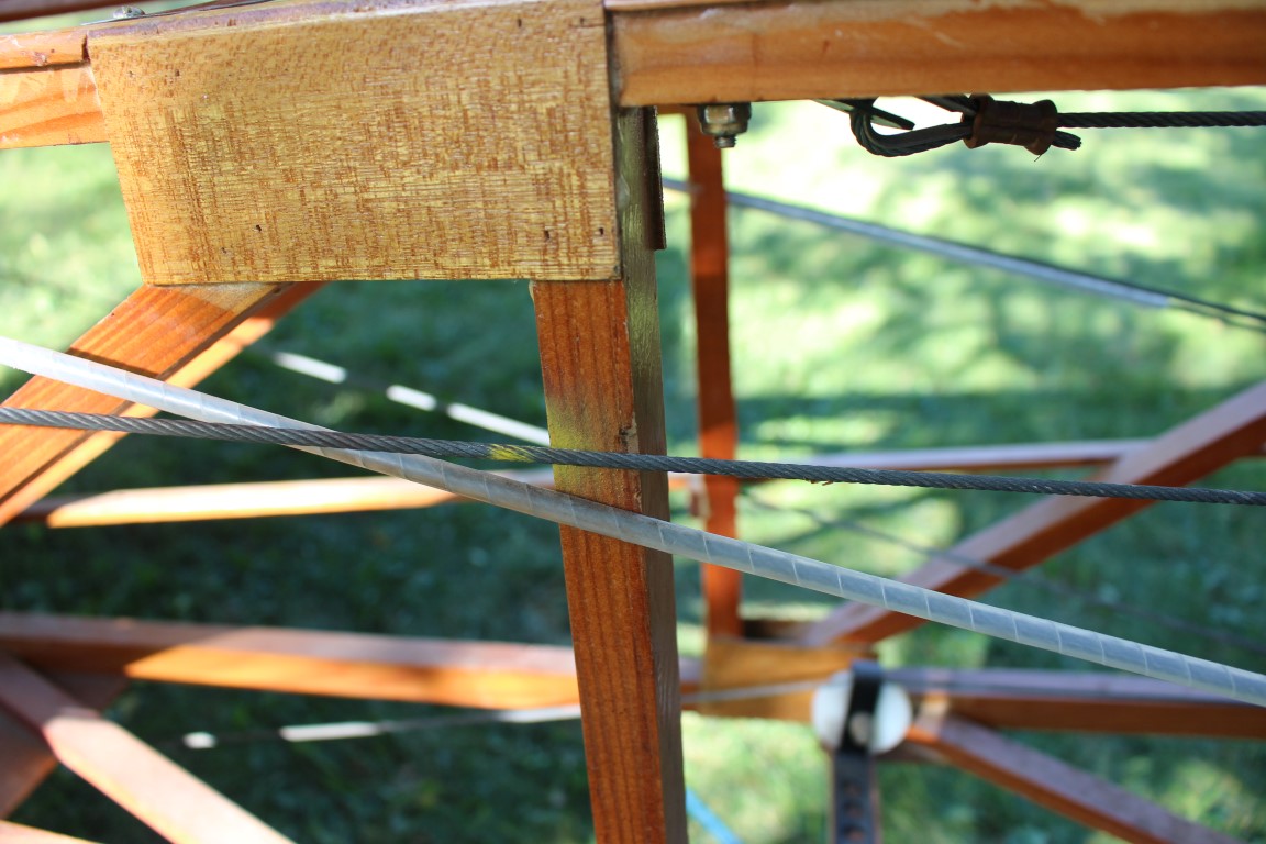

      I realize that due to the geometry the cable tension basically has to be set to
      not be too slack yet not too tight. As well as allowing it to move as it should
      without too much stick force. When I rigged it back up the elevators would
      actually hang up due to the amount of pressure the cables were holding in the
      stick. After a little playing with them I set them about as how you describe.
      I figure that's about where they needed to be but wanted to get others opinion
      on them that have actually flown the plane. Part of the issue with the tension
      may be because I didn't like how the cables were routed. You can visibly see
      they were routed in such a way that they were chaffing fairly heavily on a wood
      brace. I moved them to another location where I feel they wouldn't have that

      Yes, the plane has an EA-81 Subaru engine. Duane placarded it at 100 HP, although
      I'm not sure it really has that much since he told me he didn't do anything
      to the engine other than intake, carbs, redrive and exhaust. In other words,
      no internal changes were made. I've dealt with Subaru engines for a long time
      and know this model should really only have about 80 HP stock and with dual carbs
      and open exhaust maybe produce 90 HP if the prop will allow it to get to it's
      peak torque RPM. He said it came from a car that only had around 35,000 miles
      so it's relatively just broken in. These are hardy engines for sure! I've
      flown behind a few of them and they are very smooth with a belt redrive taking
      all prop harmonics out of the equation.
      Thanks for the information, just what I was looking for!
      I own a Teenie Two, remnants of an Avid, a KR2, hang glider and paraglider as well
      as my 1997 Pietenpol Air Camper. I'm also scratch building a Sonerai IIL.
      As a CFII/MEI I love sharing the gift of flight with just about anyone that will
      fly with me.

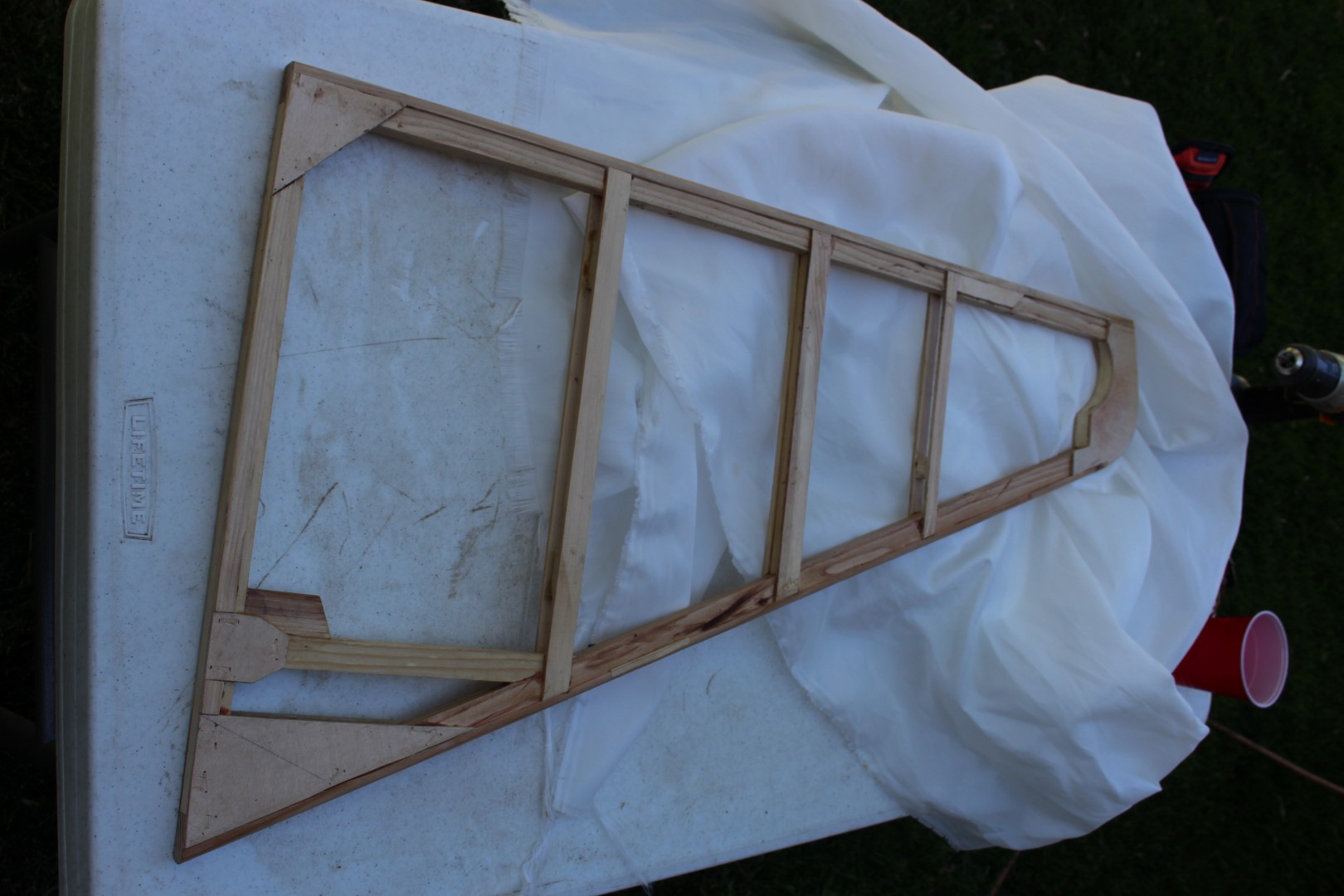

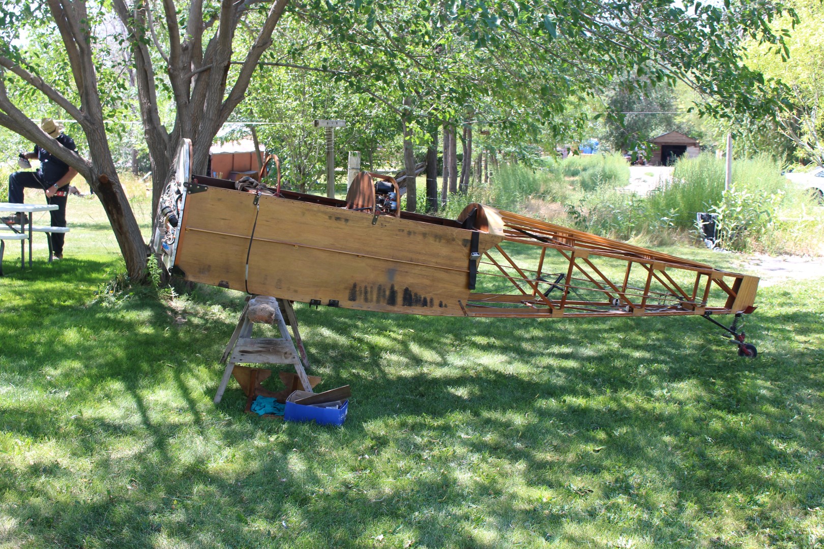

      Here's another picture showing the status of the project I picked up. As you can
      tell it's a ways from flying condition. In fact it was basically a basket case
      that I believe to have most parts to put it back together.
      There was some wood damage but nothing that I'd consider to be substantial or that
      will keep me from being able to fix it properly and get it flying again...eventually.
      It was missing the entire vertical stabilizer although I have no idea where it
      went or why it's missing. I built a new one since I do have plans. Luckily that
      is one of the few pieces of paper I have and only due to the fact that the last
      owner purchased a new set for this specific purpose.

      ll, but they also shouldn't have much slack with the elevator in that positi
      on.  At rest with the flippers down, the top cables on a stock Air Camper wi
      ll be rubbing the leading edge of the horizontal stabilizer, so not much sla
      ck in those cables.  Most builders add some sort of rub strips on the leadin
      g edges of the HS where the top cable runs over it (mine has pinked leather p
      atches glued on; the leather was cut from a shoe that I found on the side of
       the road!)  The lower cables will have noticeable slack in them in that con
      dition.

      douwe(at)douwestudios.com wrote:
      > Id say match the tension on your other Piet.  If its been flying, cant go wrong
      there.
      > Other than that, its pretty much a feeling thing.  you dont want them any tighter
      than necessary to eliminate any possibility of the elevator moving independently
      of the stick.  Were talking about from the rocking beam back to the actual
      elevator.  Youll find its actually fairly loose.  Prop the elevator up when
      adjusting or the weight of the elevator will fool you and create more tension
      on the upper cable
      > Douwe
      I kind of figured that's what I needed to do. I do appreciate the confirmation
      though. That's pretty much where I have the tension set now.
      Not sure what you mean by matching it on my "other" Piet since this is my only
      one. Maybe this post isn't in response to my question though. Either way, thanks.
      Kenneth

      Kenneth;
      If you'll notice the tail surfaces of Ray's Scout (picture it rightside up), notice
      that the flippers hang down when the airplane is parked, and that the top
      elevator cables contact the leading edge of the horizontal stabilizer.  Similarly,
      notice that there is slack (a slight belly) in the lower cables.  This is
      pretty much what things should look like back there.
