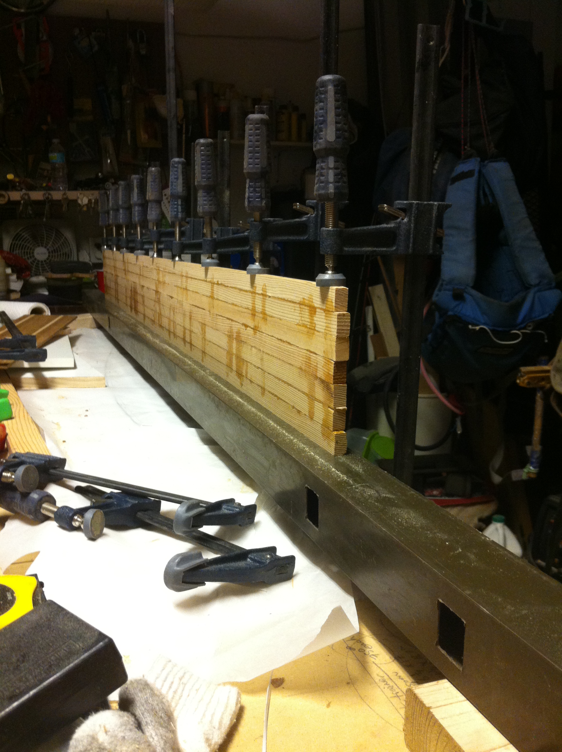

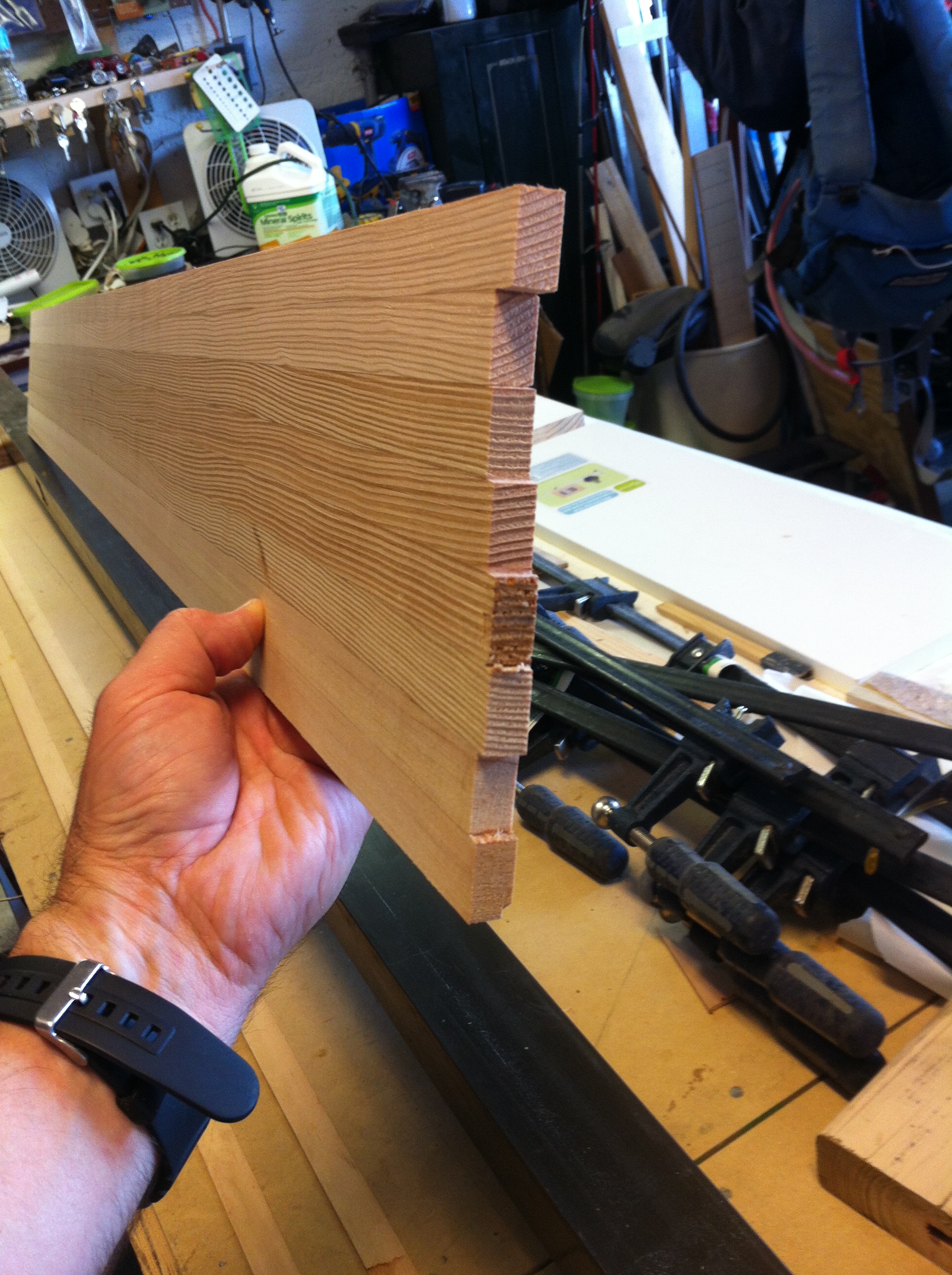

      this is how I did my center section spars. I used doug fur,but the grain was running
      the wrong way so I cut 5/8 wide strips and epoxied them atop eachother.
      then I planed the new board down to 3/8 inch and laminated on 1/8 okume ply on
      each side and lastly epoxied rails to make an I beam of 1inch wide along the
      rails and 5/8 in the web. I didnt put stiffeners behind each rib attach location
      for the center section but will be doing so for the left and right wing.
