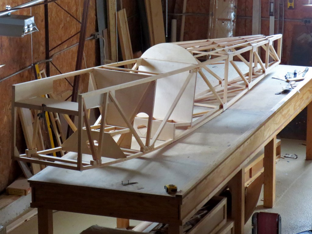

      I laminated a pair of pre-formed lower longerons for my fuselage mockup because
      I didnt want to deal with the bending operation. Each one was a sandwich of (3)
      0.333 thick x 1.5 wide strips.  I found this 3-strip bundle was very flexible
      I was easily able to clamp it in its final shape on the fuselage template (the
      wet glue even seemed to facilitate by acting like a lubricant!).  When removed
      from the mold it retained its shape with almost no spring-back. On the table
      saw I had no difficulty in cleaning up the sides to bring it down to 1 wide.
      This was only a pine/Titebond III mockup, but I found it remarkably easy to do,
      and strong & stiff.  I felt it greatly simplified the task of building up the
      fuselage sides because I didnt have to fight with the pieces.  On the down side,
      I had to use every clamp I owned, and then some to make sure there were no
      gaps anywhere.     Jim

      Great pix! I am also building a mock-up fuselage (as recommended by Tony Bengilis).
      I've also thought about being able to laminate the lower longerons without
      steaming first.
