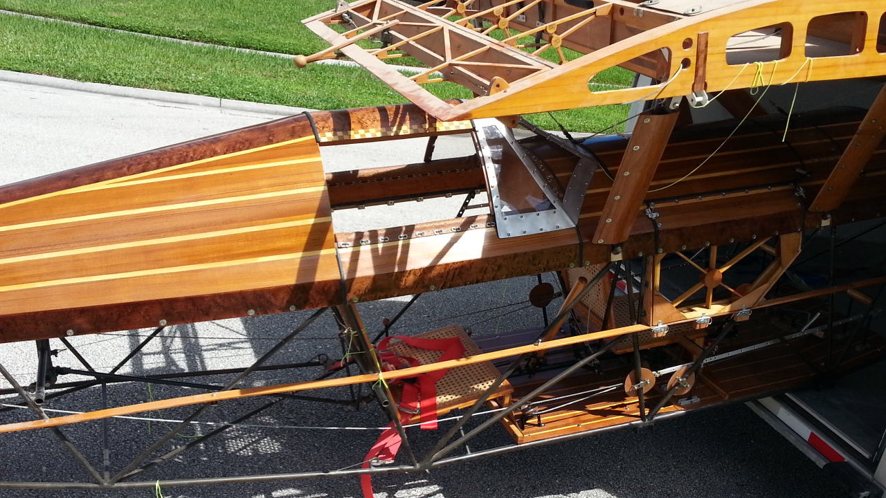

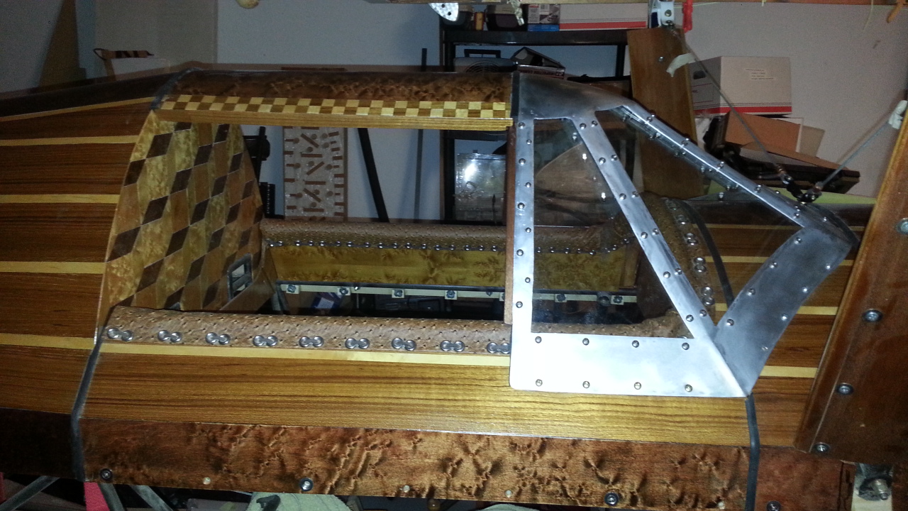

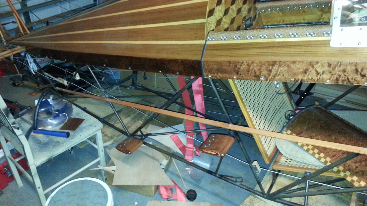

| Subject:  | Re: Cold Weather Piet |
      I haven't fully enclosed it yet but probably will build that option for the florida
      to Broadhead trip. after I step in the little top canopy fits in place via
      a couple of dowels in the aft portion and a couple of spring loaded  sliding
      pins in the front. a left and right pieces (not uet constructed) can be hinged
      from the bottom and latched to the top piece.  one of the pics shows two steps
      that are needed to get in the cockpit. with the flop forward I can actually
      stand straight up while stepping in. should be able to get in their well into
      my 90's.
