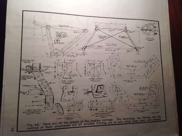

      Tony,
      You say you built your gear "per the dimensions." The plans I bought from Doc M.
      are so bad I can't read the dimensions! If anyone can provide the dimensions
      from Fig 6A, page 14. I'd appreciate it.

      Tony,
      I think perhaps you used the wrong detail for your axle.  The FGM drawings call
      for the axle to be 1 1/2" OD x 12ga chrome molybdenum.  The axle collar, that
      slips over the axle is drawn with 1 1/2" ID and 1 3/4" OD.
