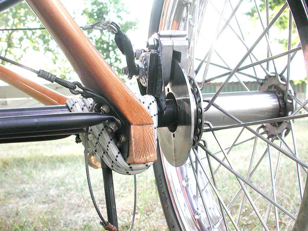

      While we're on the subject of wooden gear, am I missing something as far as the
      axle and bungee arrangement? I can't find anything on the drawings showing the
      cage or bracket that retains axle in case of bungee failure. I'm sure it's right
      under my nose, and as usual, I will probably realize the answer right as
      I hit the "submit" button...

      Jon,
      What most due is put a loop of aircraft cable around the axle and the V block .
      Here is a picture
      http://forums.matronics.com/viewtopic.php?p=464786#464786
      http://forums.matronics.com//files/dscn2484adj_852.jpg
