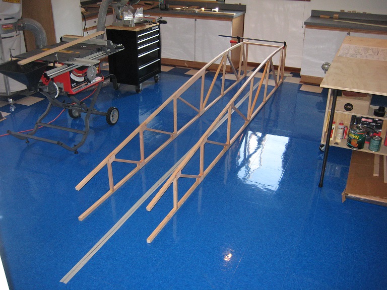

      > Hello John. Here is what I did to join my fuselage sides. (The pictures as
      > shown are in reverse order...strange...)
      > Fist off, you must work with a center line. As shown in Picture 1, I put
      > tape on the floor and drew a straight line down it. I used this very
      > center line for numerous items through out the build, so do not be in a
      > hurry to remove it. (Mine was used for months.) I started with the
      > fuselage sides upside down; the flat longerons on the floor and worked
      > from the front towards the rear, adding and clamping the connecting pieces
      > as I went. This allowed the fuselage to take on a nice, even shape.

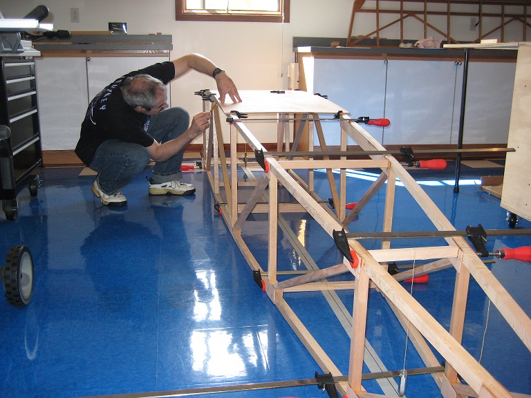

      > I drew a center line on each cross member piece, (Picture 6) and dropped a
      > plumb bob down to match with the line on the floor. (Picture 2) I worked

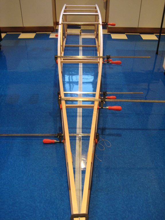

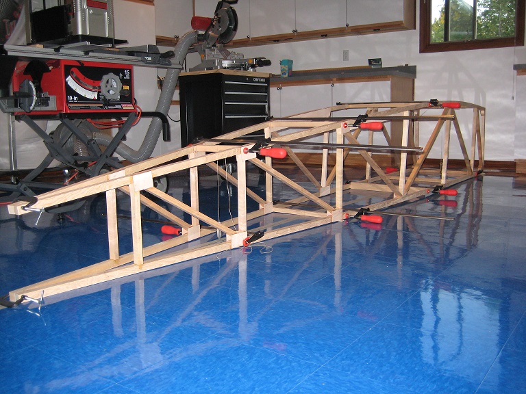

      > my way back, gluing, clamping, checking center lines and adding cross
      > pieces both top and bottom. (Picture 3 and 4) Note that I utilized two
      > plumb bobs at all times, just to be sure the front and rear stayed true on
      > center.
