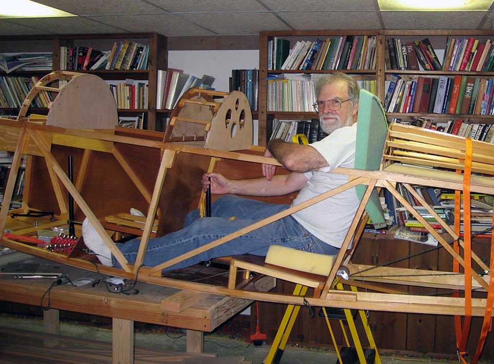

Yes I did lean my seat back. I think it was 10 deg, whatever "Uncle"
Tony recommended. I have no problem with seat comfort. I am using
temporary temperfoam pads until I decided what thickness and density I
want.

I forgot to post a picture of me trying on the rear cockpit seat for fit. With
the side off you can clealy see the leanback.
