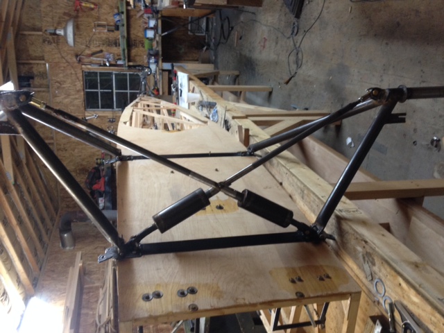

      I built my gear using the  WW die spring method.  I got my springs form AS
      and built them close to his plans as possible .   I did connect mine to the landing
      gear attatchment point and not to a center v as some do .  I have been very
      happy with the set up
      http://forums.matronics.com/viewtopic.php?p=465348#465348
      very happy with the set up

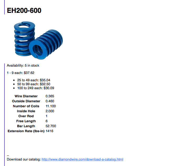

      Ben,
      I had posted this on the Pietvair forum a while back. But since you are unable
      to see that, I am sharing here. The spring shown is the one I used, and it is
      a good bit cheaper than what can be found elsewhere.
      I hope the info helps.
      Semper Fi,
      Terry Hand
      Athens, GA
      http://forums.matronics.com/viewtopic.php?p=465353#465353
      http://forums.matronics.com//files/img_6219_837.jpg
      http://forums.matronics.com//files/die_spring_gear_measurements_dragged_1_156.pdf
      http://forums.matronics.com//files/die_springs_info_394.png

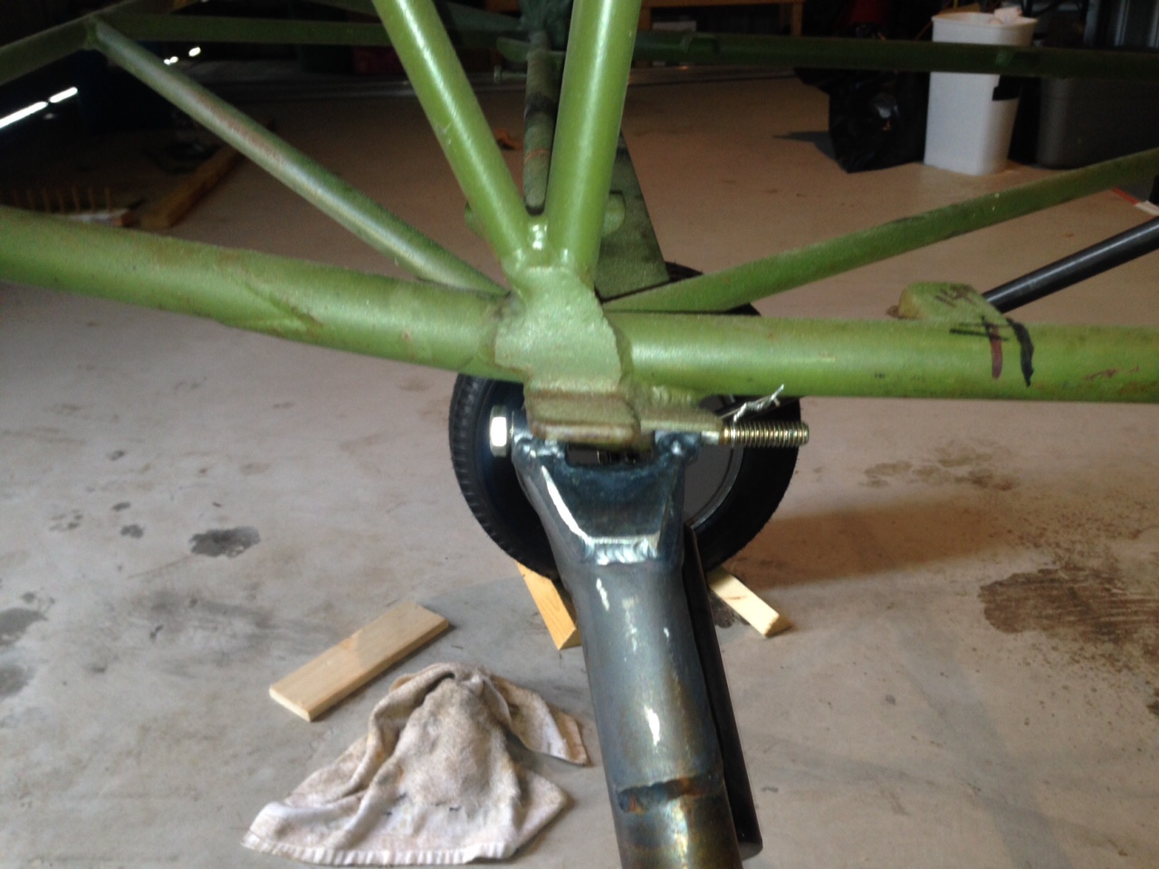

Message 15
| Subject:  | Re: Spring Landing Gear designs |
      Ben I bought mine at a local Fastenal
      Jack Textor
      Sent from my iPad
      > On Jan 22, 2017, at 5:19 PM, Ben Charvet <bencharvet@gmail.com> wrote:
      > Did you buy large washers for the tube caps, or make your own?
      > Sent from my iPhone

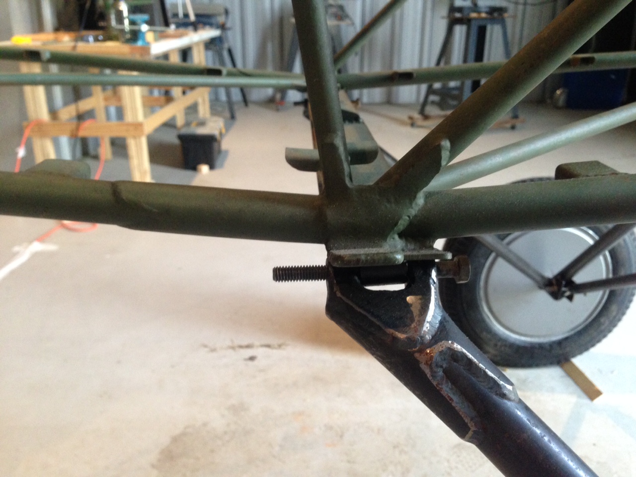

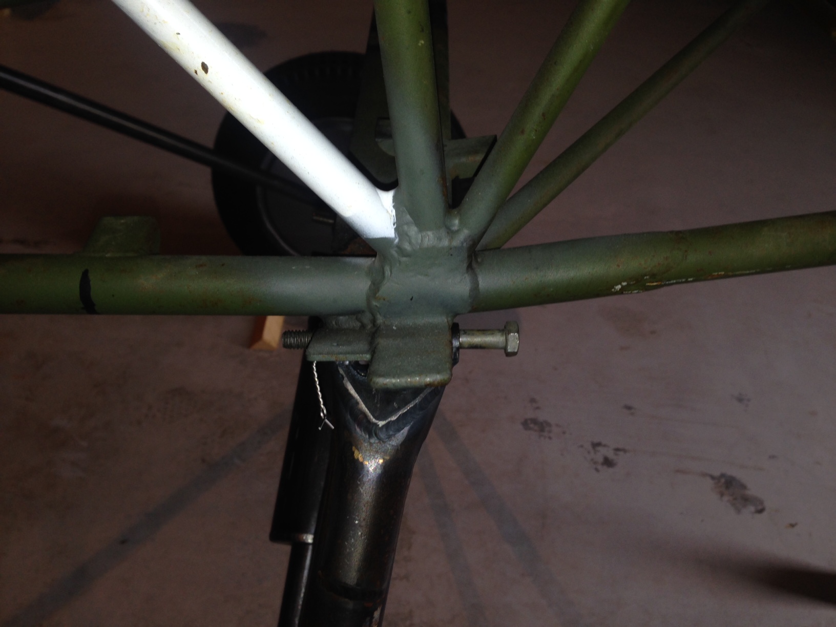

      landing gear attatchment point and not to a center v as some do .  I have been
      >> http://forums.matronics.com//files/landing_gear_finished_1_886.jpg

Message 17
      Ben,
      Semper Fi,
      Terry Hand
      Athens, GA
      http://forums.matronics.com/viewtopic.php?p=465356#465356
      http://forums.matronics.com//files/die_spring_gear_measurements_dragged_1_477.jpg
      http://forums.matronics.com//files/die_springs_info_191.png
      http://forums.matronics.com//files/img_6225_144.jpg
      http://forums.matronics.com//files/img_6223_163.jpg
      http://forums.matronics.com//files/img_6221_168.jpg
      http://forums.matronics.com//files/img_6219_195.jpg
Message 18
      I believe I bought large washers at the local hardware store.   Seems I did have
      to do some grinding  work to get them to fit.
      http://forums.matronics.com/viewtopic.php?p=465358#465358
