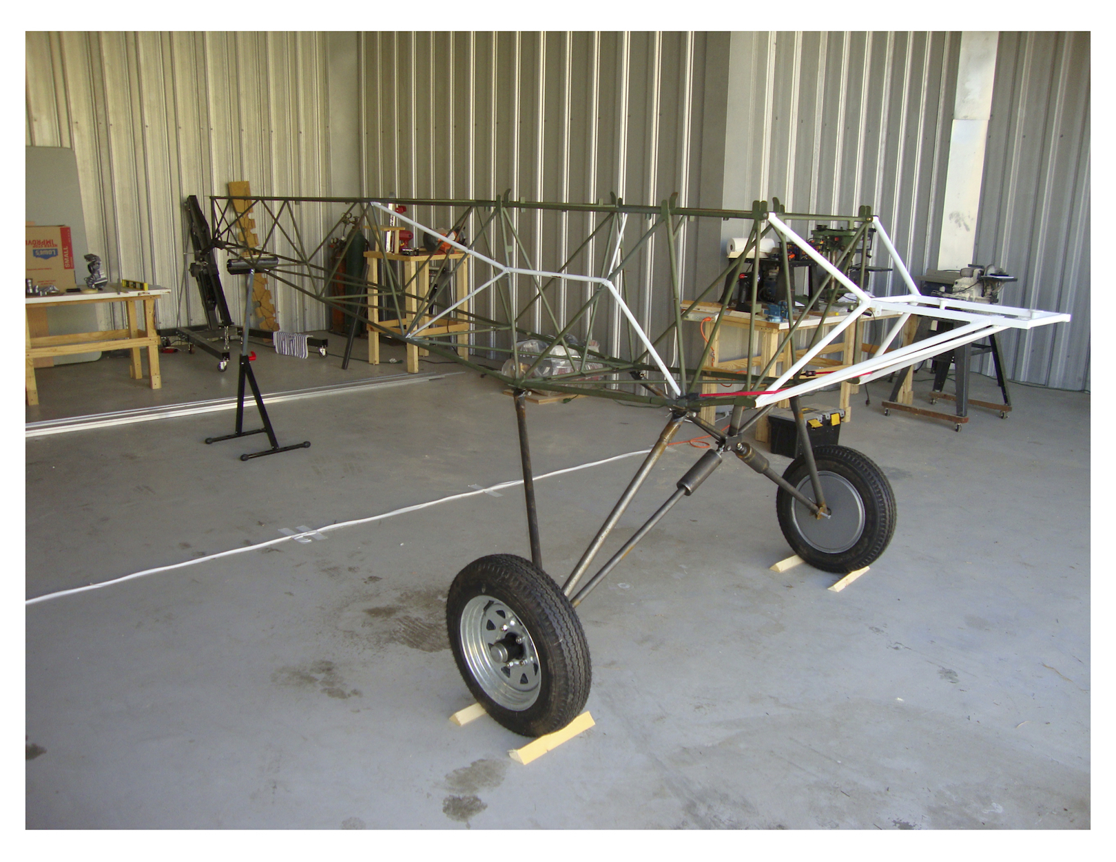

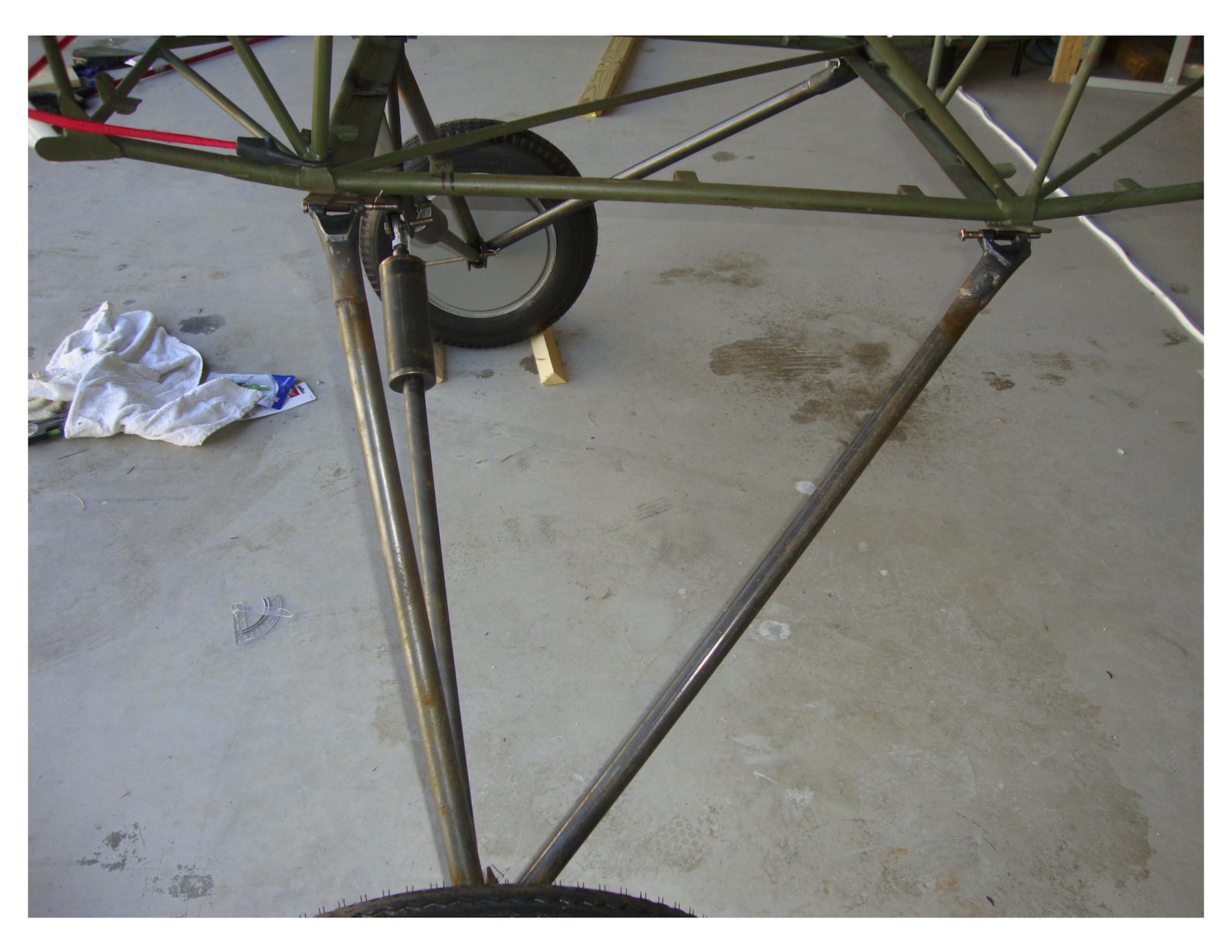

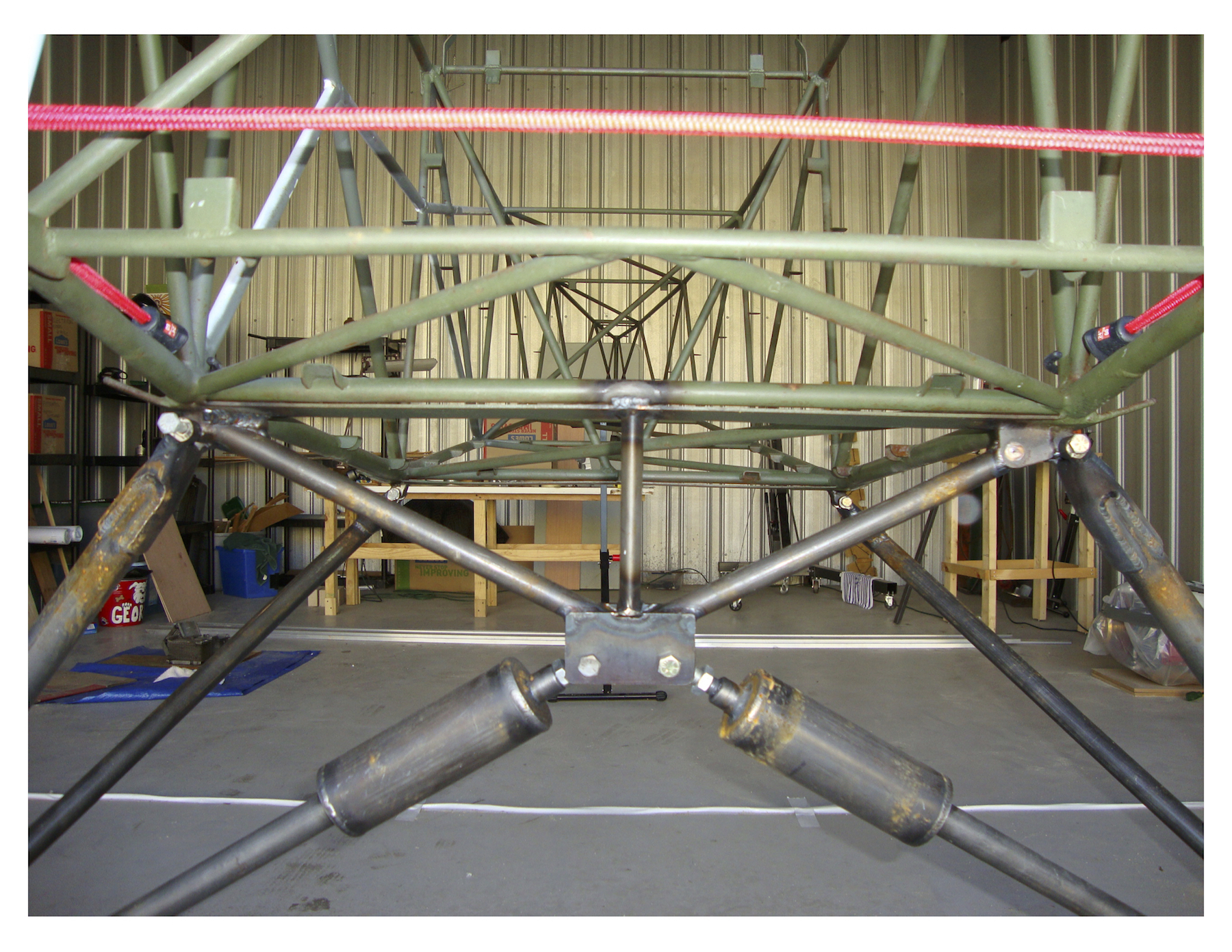

Message 5
| Subject: | Re: DIe Spring gear |
Look at the pictures below and these measurements, hopefully, will make sense -
The die spring "can" is made of 2.25 inch diameter tubing.
The die spring rod is 1" in diameter.
The various metal plates are 0.125 thick
The diagonal tubing above the plate in the center top of the gear is 0.75 in diamter.
The streamlne tubing between these two tubes is approximately 1.5 inches
in depth.
The gear legs - the front tubes are 1.25 in diameter, and the rear tubes are 1.125
in diameter.
The bolt at the top of gear legs is, I believe an AN4, and the bolt down by the
axle is an AN6
I hope that all this is useful. Oh, and the aircraft attitude is about 12.
Semper Fi,
Terry Hand
Athens, GA
http://forums.matronics.com/viewtopic.php?p=469315#469315
