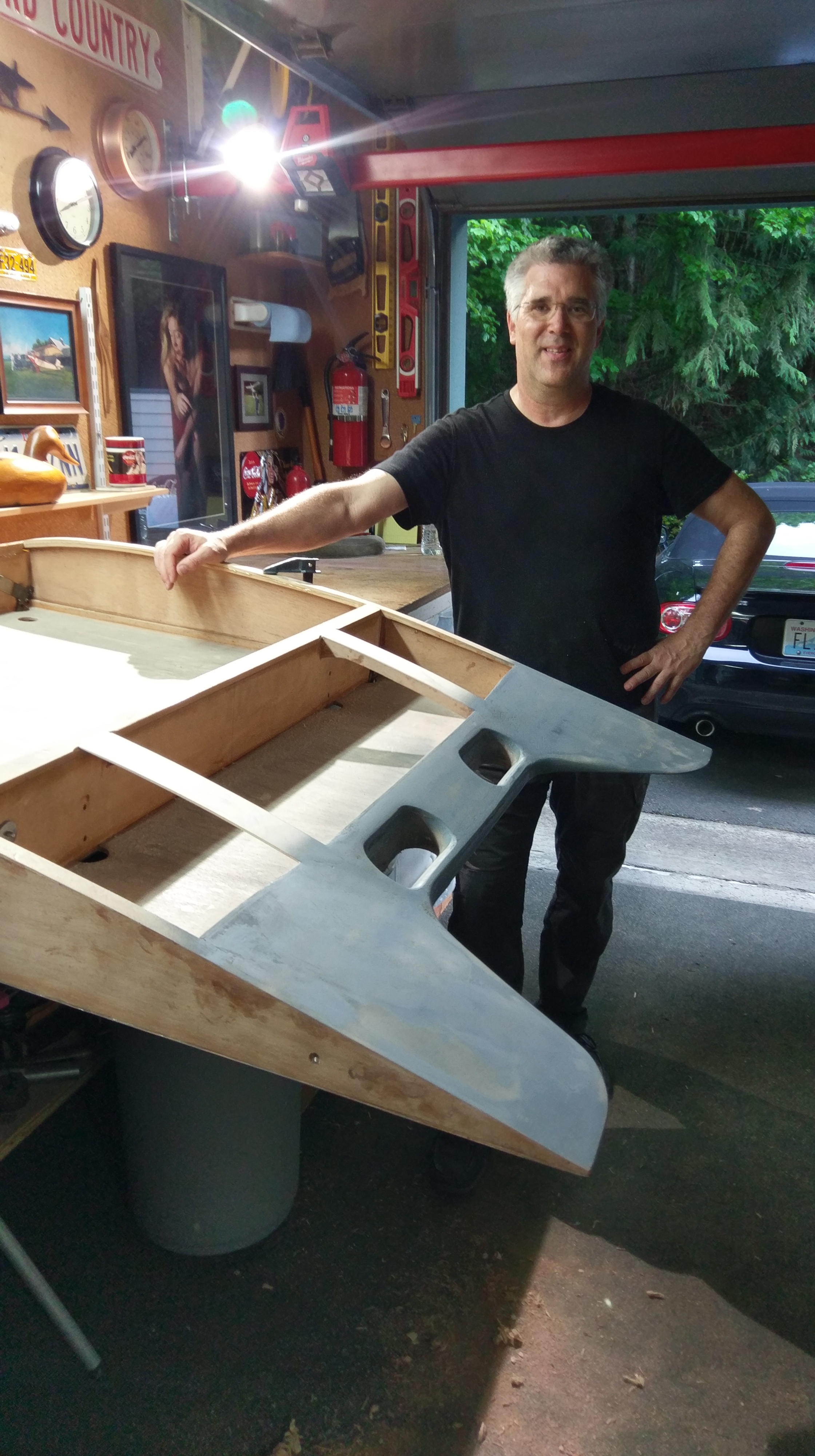

Hello good Piet-ple,
Been out of touch for a while yet still moving forward nicely on my project.
Terry, here is a photo of my tailpost hinge prior to welding. I can't find a good
photo of that specific area after welding...?!?!? The three rudder hinges
line up real well yet you have to be very careful to always mount the horizontal
stabilizer with the same number of washers/shims so the three rudder hinges
are spaced properly.

| Subject: | Re: The Kapler/Zuniga hinge on a steel tube fuselage |
Somewhat on the same subject...since the location of this hinge half is done pre-covering,
does the thickness of covering on fuselage and horizontal and vertical
stab add enough thickness to make alignment off? In other words, does any
allowance need to be made for covering, or is it insignificant enough it doesn't
matter.
Jon Jones
Ironton, MO
http://forums.matronics.com/viewtopic.php?p=469541#469541
good point... it may not be critical but my horizontal stabilizer is mounted on
washers and I could adjust them if needed. I suspect that will be one of the
many things that crop up when one re-assembles the plane after covering/paint....
I guess I'll just skip the covering altogether - ha!
Jake Schultz - curator,
Newport Way Air Museum (OK, it's just my home)
http://forums.matronics.com/viewtopic.php?p=469552#469552
Jake,
A picture is worth a thousand words (maybe two thousand for this air line pilot).
Thanks!
I should probably cover the plane before I fly in....
http://forums.matronics.com/viewtopic.php?p=469571#469571
http://forums.matronics.com//files/imag0723_789.jpg
