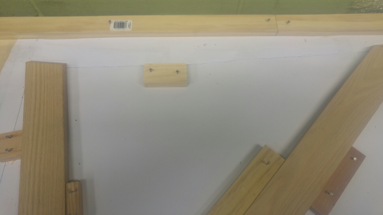

So pulled the gear leg out of the jig and put it against the fuselage to test the
fit. Wasnt even close. Did some trimming and ended up with a leg way out of
spec. Scrapped it and did take two with a template of the bottom of the fuselage
to go by. Hopefully this one will fit better.

I built an ultrapiet years ago. Always check dimensions using actual parts youve
built. Seems like a lot of the drawing dimensions dont match previously built
parts. Have you done cabanas or center section yet? LOOK OUT? Weight and balance
was way off too. Be really careful. Flying it was fun but for the money,
you might be further ahead and build a scout
