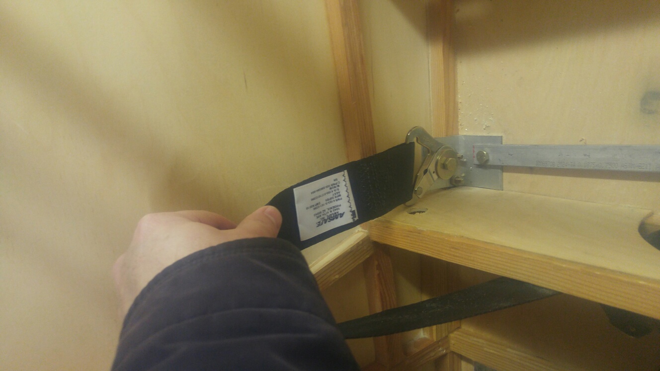

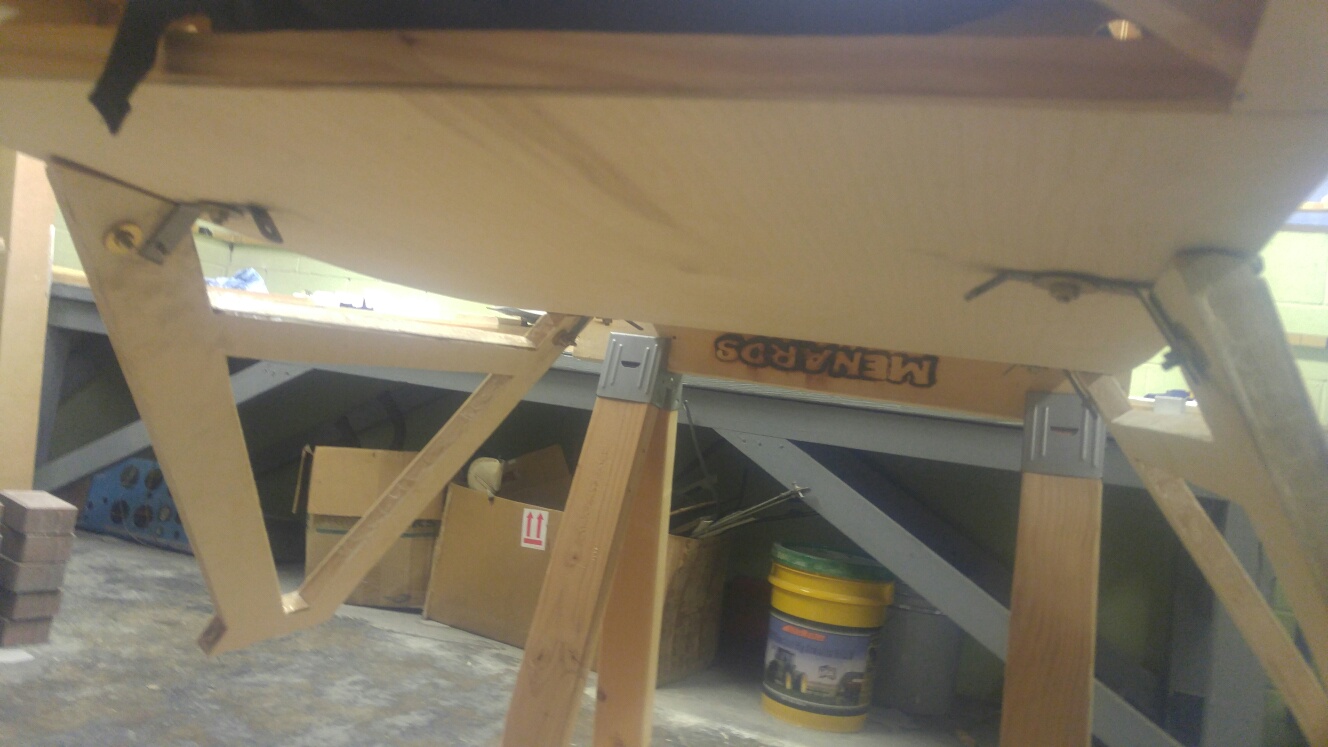

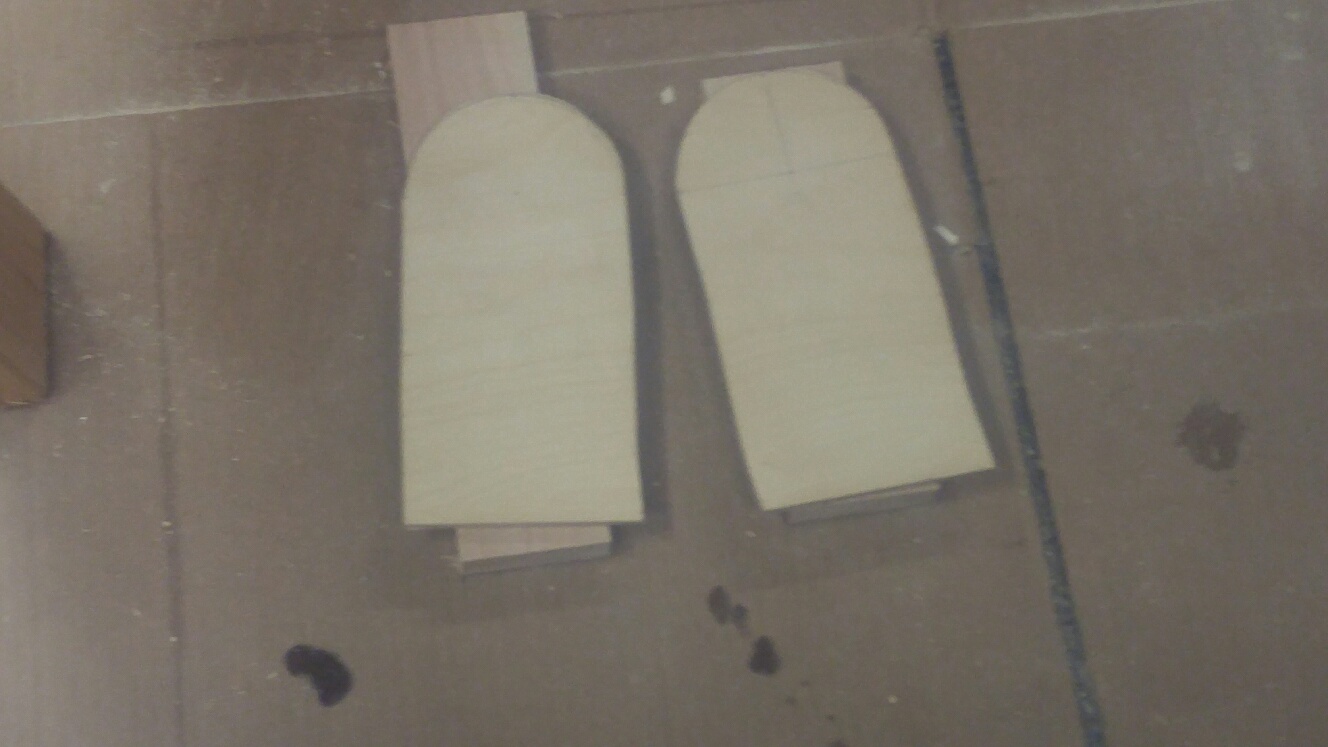

      Progress update. Metal fasteners are fabricated and did the seat belt attachments.
      Then the gear was removed so i can use a router on it to round off the edges.
      I also need to varnish it and the holes i drilled in the wood. I did some
      varnishing and made rudder peddles. The posts for the center section are cut out
      of fir.
      http://forums.matronics.com/viewtopic.php?p=479020#479020

      The bottom of your gear isn't at the right angle.
      Making the gear leg is the hardest part of the project

      What do you mean Cessna. The gear leg has no right angles and it goes out from
      the fuselage at a 37 deg angle

      Chad, I suspect that what Cessna is referring to is the orientation of the
      short block that will be parallel to the ground during landings.  The angle
      at which it is currently set is not flat relative to the axle.  Take a look
      at that piece from the Jenny-style gear that I originally had on my Piet.
      Ken

      I see what you mean now
