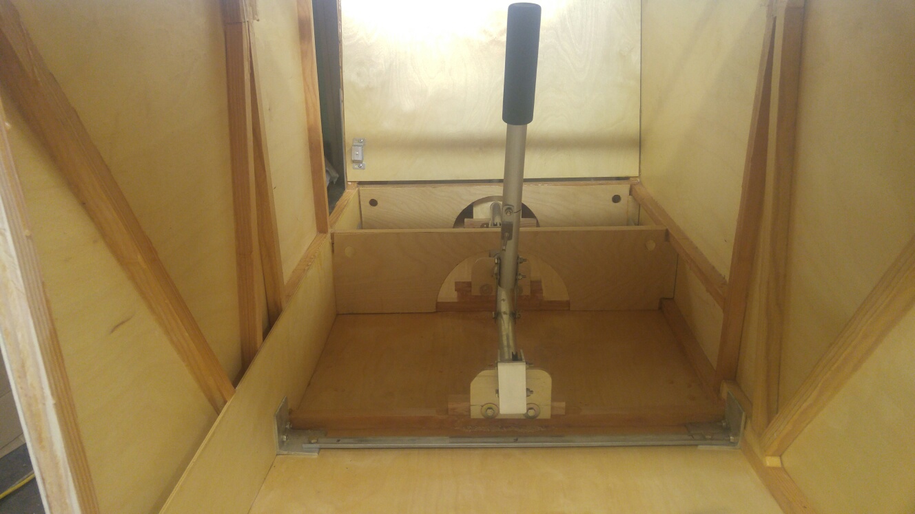

Been working on the little piet here and there. The landing gear is coming along.
The torque tube and controll stick is completed and installed. Lots of varnishing.
http://forums.matronics.com/viewtopic.php?p=481640#481640
http://forums.matronics.com//files/20180713_130237_resized_140.jpg
http://forums.matronics.com//files/20180713_125353_resized_156.jpg
http://forums.matronics.com//files/20180713_125409_resized_136.jpg
http://forums.matronics.com//files/20180711_155745_resized_130.jpg
http://forums.matronics.com//files/20180626_143631_resized_724.jpg
http://forums.matronics.com//files/20180619_170220_resized_142.jpg
